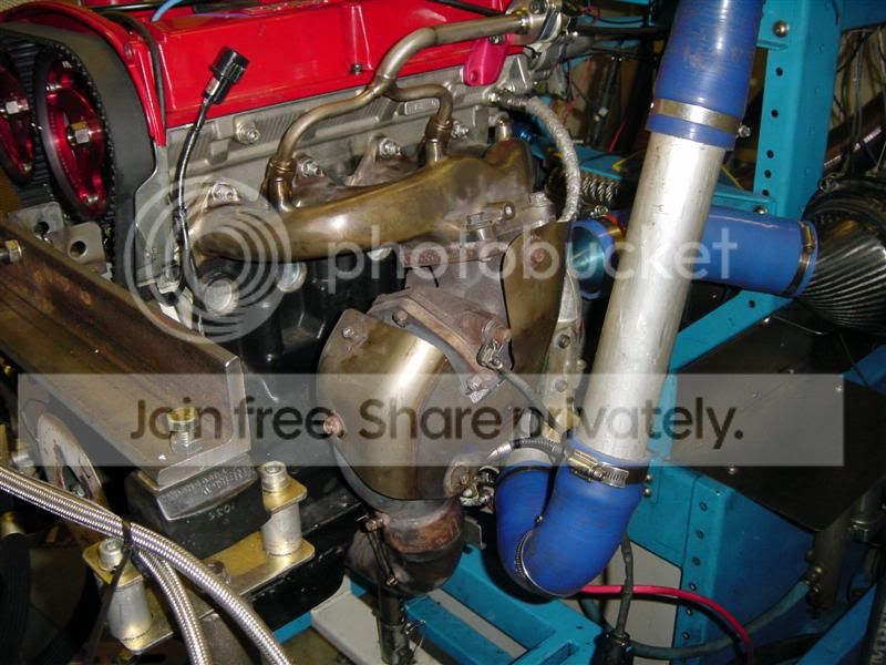

211Ratsbud's Avatar
Joined: Oct 2010
Posts: 4,286
Likes: 43
From: Watertown, NY
Originally Posted by donner
You don't need to use DMA functions but when tuning big 3d VE map you should To use it as normal rom just set all pointers to rom addresses.
Download 88586714 rom with xml's from www.petterimutteri.fi
ok ive been sifting through this rom, and I frankly dont understand what I need to change to make sure everything is in ROM.
i see the pointers, but what do I change?
Also, Im seeing some odd timing results
my piping looks very similar to this now except the main tube is the same size as the tubes that are feeding each bank. Maybe I can revise this too
