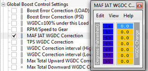

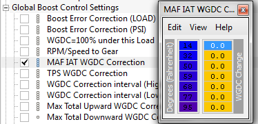

Joined: Oct 2010
Posts: 402
From: L.I. New York
I didn't see the "Y" box checked marked on MAF IAT WGDC Correction.
made another run.
Not sure why Evoscan is not picking up Boost Error and WGDCCorr?
Only good thing is that I'm not over boosting anymore.

He's referring to the WGDC table, not MAF IAT table.
