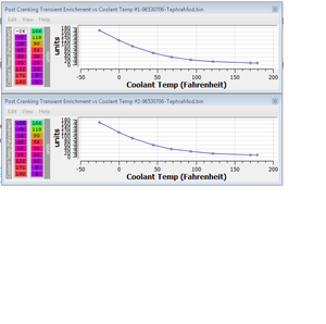

I adjusted all values in the Initial Cranking IPW vs. Coolant Temp table using the formula I posted. If you don't you'll run rich enough to flood your plugs during startup. E85 doesn't atomize as well as regular gas at lower temps so you actually need to increase the values at lower temps to compensate after applying the formula. Here is the original V7 96530706 table for reference.
FWIW I also applied the formula to adjust values for E85 in the Post Cranking Transient Enrichment vs Coolant Temp #1 and #2

Originally Posted by Mr_G
Any chance you have the original table values for Post Cranking Transient Enrichment vs Coolant Temp #1 and #2 ?
Here you go.....
Attached Thumbnails V7  E85 starting table Q's: 96532706-postcrank.png
