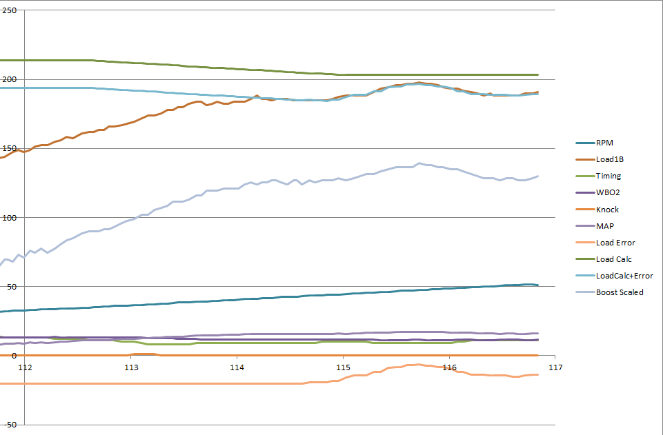

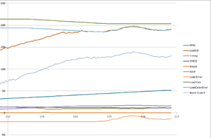

Trying not to stray from the topic here, but I think that I figured out how to do the improved load-based boost control for 96260009, but I'll wait for MrFred's response. There are at least a couple extra things to log that I don't know. Attached is my log from last night with the load control improved (I think!).
First time in a while that I haven't gotten knock, too. Was getting crazy knock on a hot day a couple of days ago, which could have been explained by the car over-boosting to reach BDEL levels.
