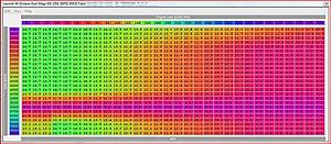

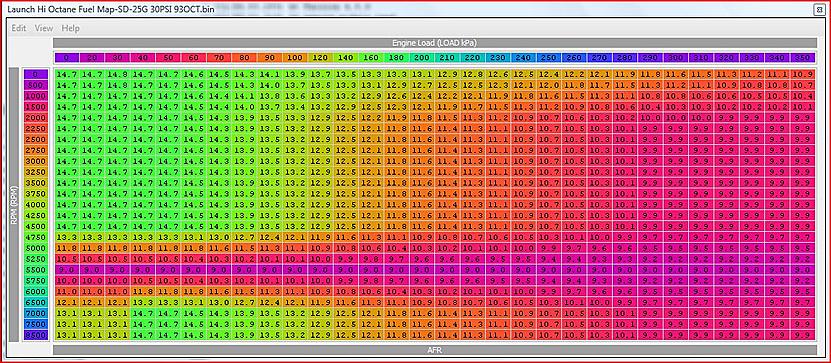

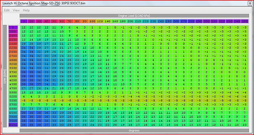

VIIIdriver's Avatar
Joined: Feb 2011
Posts: 442
From: Sanford fl.
Originally Posted by awdordie
not quite understanding what your saying boosted91t
would you mind posting an example?
i dont see how you could smooth it out in more than a few cells which is what im assuming is all you would be using. if i copied in my tuned timing and fuel maps to the launch maps, and didnt change anything just did a log during two step shouldnt i only mess with the 5500 row and around 120 or so load (whatever load the log says) and tune those cells? or should i be tuning the whole entire map and retarding timing out of the entire map up to the point of two step?
This is the way i like to do it!
Attached Thumbnails tephra launch maps-launch1.jpg   tephra launch maps-launch2.jpg
How do those maps work for you?
What are your 60 foot times?
