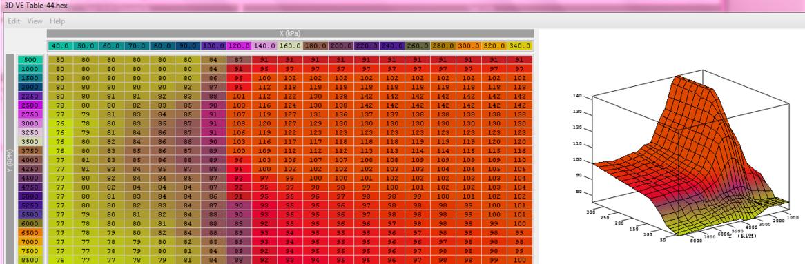

3d is tedious but you can get open loop cruise idle and light throttle fuel dialed in easily in a couple hundred of miles.
Matching your existing timing map maf loads is where the sd map is coming into play
heres an example of a sd 2.0 set I run. my 3d ve map is a bit smaller than your normal map but i run something a little different anyways.
You will have an easier time on stock injectors. Which is actually kind of nice because you know exactly what latency and scaling to go with. Infact SD 2d might not be so bad, but Ive never really tried it. TSC may be able to chime in there.
