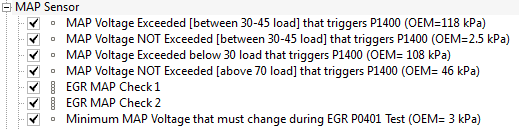

So I have a huge pet-peeve with the way some of these tables get labeled so the common user has NO FRIGGIN CLUE what they really mean unless you are a coder geek. So I just decided to reword the MAP sensor tables so it may be a bit easier to understand what the value does.
Here are the standard descriptions and below is what I used to help explain their use a bit more. I still havent dug into the EGR MAP check tables yet though.
2003-2004 Evo 8's with MD305600 MAP sensor
MAP Test 1: Mid VE Max Voltage (4.63 volts)
MAP Test 1: Mid VE Min Voltage (0.10 volts)
MAP Test 2: Low VE Max Voltage (4.22 volts)
MAP Test 3: High VE Min Voltage (1.80 volts)
EGR MAP Check 1
EGR MAP Check 2
EGR Pressure Diff (0.12 volts)
Here are the factory MAP Sensor test conditions:
-Jamie

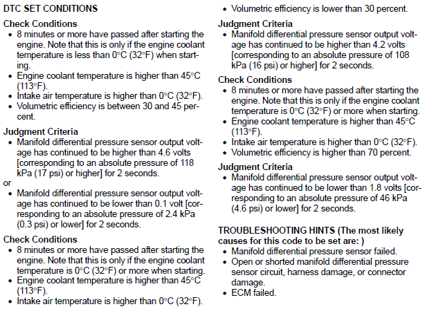

There are more than a few clues to be found delving into the FSM.
Amending my def right now.

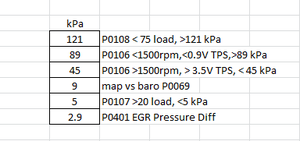

Old May 11, 2013 | 10:28 PM
Dynotech Tuning's Avatar
Joined: Jan 2011
Posts: 1,312
Likes: 9
From: Seekonk, MA
So I tracked down the parameters for the Evo 9 but they don't seem to correspond with the values that are currently in a stock Evo 9 USDM rom. I think we may need to have someone do some digging in the code.
In case anyone didnt know, the scaling for kpa is x*0.5 and its uint16.
-Jamie
