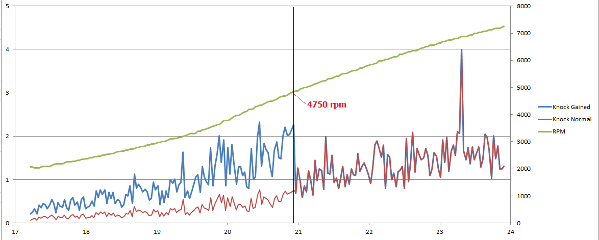

Is there a specific RPM value that triggers when the ECU switches from TRIPLE GAIN to SINGLE GAIN or is it switched when the average triple gain level exceeds a specified voltage?
-Jamie
Attached Thumbnails knock sensor triple & single gain switching point?-knock_voltage.png

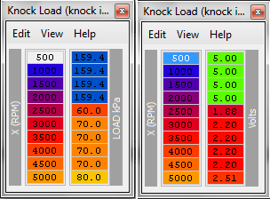

I wonder if its possible that the knock LOAD Threshold table is actually a knock voltage GAIN threshold?
EDIT: NVM, tested this and my theory is not correct lol.
-Jamie
Attached Thumbnails knock sensor triple & single gain switching point?-knock_gain_threshold.png
