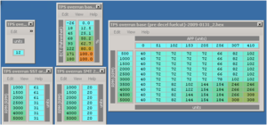

I guess these are the tables for 59590004. The last 3 tables use a different type of header structure so it's harder to find them (not to mention the scales). So I would ask someone else to validate them.
These tables are also higher resolution tables compared to 53040010, as you can see from the attached picture, with somewhat different values too.

52360018 (2008 jdm 5mt)
Found in 52360018 (2008 JDM 5MT), thanks.
There is not too much about themselves information about "TPS overrun - minimum APP change to activate".
52680018 USDM : 16
52360018 JDM : 12
Code:
	<scaling name="x2_byte" units="units" toexpr="x*2" frexpr="x/2" format="%.0f" min="0" max="510" inc="1" storagetype="uint8" endian="big"/>
	<scaling name="x4_word" units="units" toexpr="x*4" frexpr="x/4" format="%.0f" min="0" max="510" inc="1" storagetype="uint16" endian="big"/>
	<table name="TPS overrun - minimum APP change to activate" category="Misc" address="548d2" type="1D" scaling="x4_word"/>
	<table name="TPS overrun base (pre decel fuelcut)" category="Misc" address="5fe01" type="3D" swapxy="true" scaling="x2_byte">
		<table name="APP" address="629b6" type="X Axis" elements="8" scaling="uint16"/>
		<table name="RPM" address="6299c" type="Y Axis" elements="10" scaling="RPM"/>
	</table>
	<table name="TPS overrun base (pre decel fuelcut) ECT Multiplier" category="Misc" address="5fe56" type="2D" level="2" scaling="Percent255">
		<table name="ECT" address="60fde" type="Y Axis" elements="8" scaling="Temp"/>
	</table>
	<table name="TPS overrun 5MT 2nd+ decay rate decider" category="Misc" address="5fdec" type="2D" scaling="uint16">
		<table name="RPM" address="62988" type="Y Axis" elements="7" scaling="RPM"/>
	</table>
	<table name="TPS overrun SST or 5MT 1st decay rate decider" category="Misc" address="5fdd8" type="2D" scaling="uint16">
	</table>
Attached Thumbnails Sharp Accelerator drop --&gt;&gt; TPS maps-screen-shot-2014-06-15-10.02.17-pm.png
