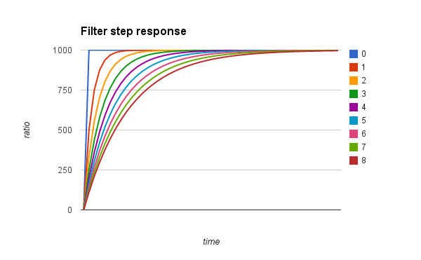

Old Apr 6, 2015 | 03:37 AM
Rcus's Avatar
Joined: Apr 2012
Posts: 18
From: Amsterdam
ratio_filtered = (ratio_filtered * filter_strength + ratio_unfiltered) / (filter_strength + 1);
Attached filter step response graph for strength in range of [0;8]
Attached Thumbnails RPM/SPEED ratio filter strength-image.png
