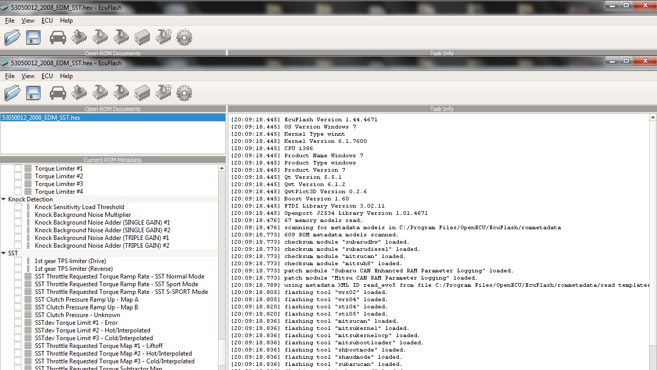

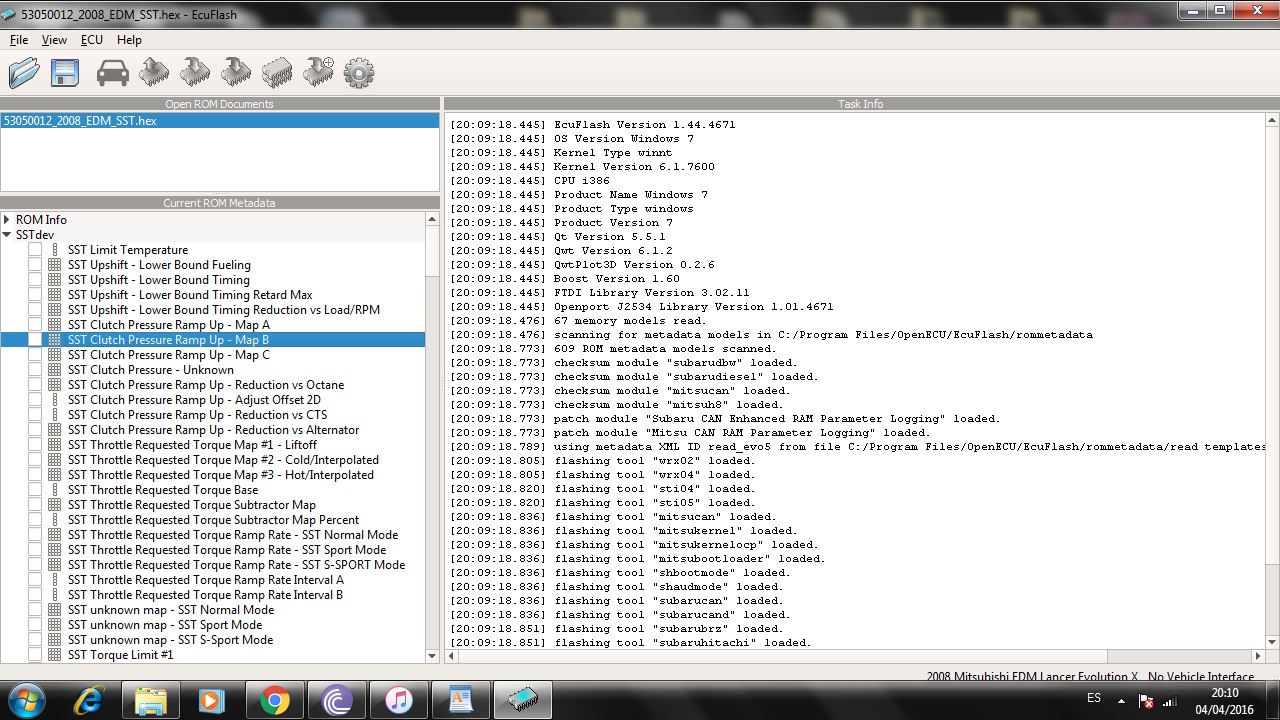

Originally Posted by gsxrmel
Attachment 250139
Attachment 250140
thanks beeble, with this xml i have 2 sst tables references it is correct? and also have a ommipower 4 bar sensor dates can i use this xml with the stock map sensor
regards
yes it has bits of everything there so some sst tables will repeat. it was some old development stuff .
there will be Omni 4bar and also normal 3bar tables there to use

From: spain
and i need to tuning the two bits of sst ?
Old Apr 5, 2016 | 02:47 PM
  #184
Beeble's Avatar
Joined: Feb 2009
Posts: 340
From: Australia
^^ the second sst section has pretty much everything you need
the top sst section, development - you can ignore most of it
