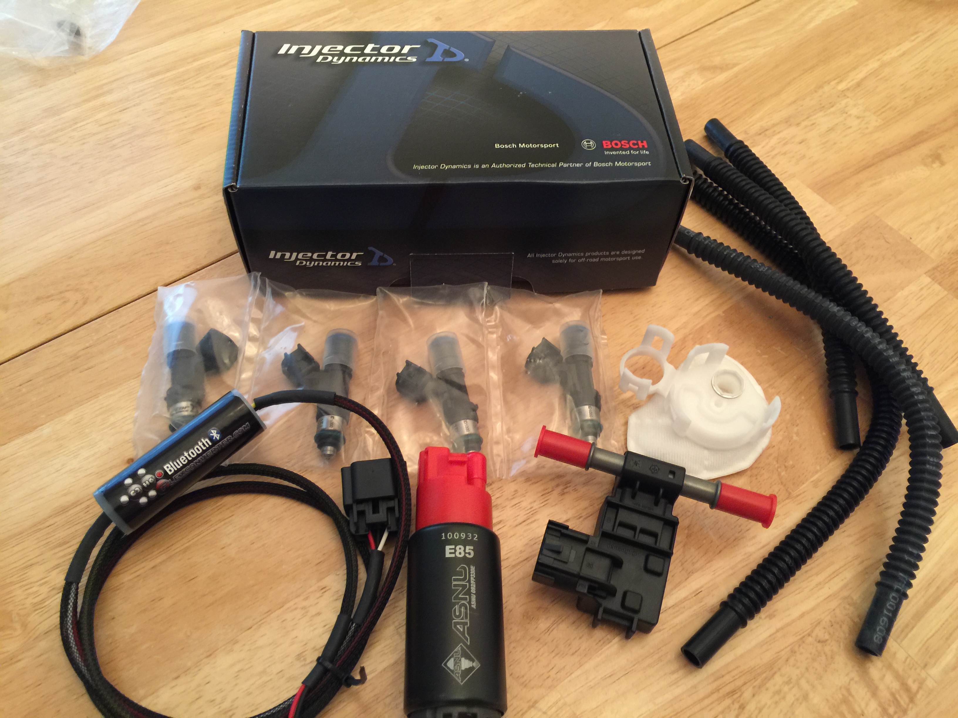

I finally have all my parts to go flex fuel !! Can't wait for it to go public !
My parts list ....
ID1000 injectors
ANSU 330 fuel pump
GM flex fuel sensor
Flexconverter/Bluetooth cable
A old Android phone for the flex fuel App.

Have all my parts for FlexFuel .. Just waiting for
It to go public
