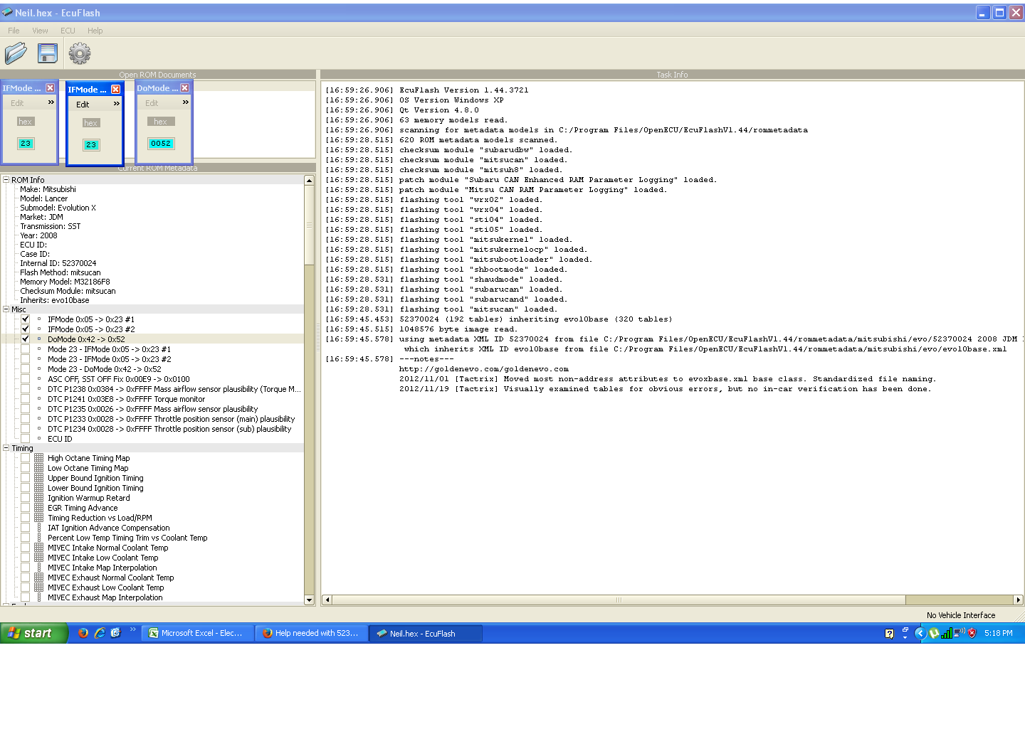

Thanks for the response, yes I do believe I made the correct changes, I think the problem might lie with my evoscan. Is there any patching that needs to be done to evoscan to be able to log?

Looking at your image, it seems that there are two sets of mode23 tables.
a)IFMode 0x05 0> 0x23 #1, IFMode 0x05 -> 0x23 #2, DoMode 0x42 -> 0x52.
b)Mode 23 - IFMode 0x05 -> 0x23 #1, Mode 23 - IFMode 0x05 -> 0x23 #2, Mode 23 - DoMode 0x52 -> 0x52
Make sure the tables have correct addresses and delete either a) or b).
After surely flashing modified rom, use latest version of evoscan.(v.2.9.0100)
Before trying mode23, can you take a correct log with "EVOX CAN MUTIII"? If you can't, make sure that OpenPort 2.0(J2534/CAN/EvoX) selected, CAN 2006+(EvoX) checked.
