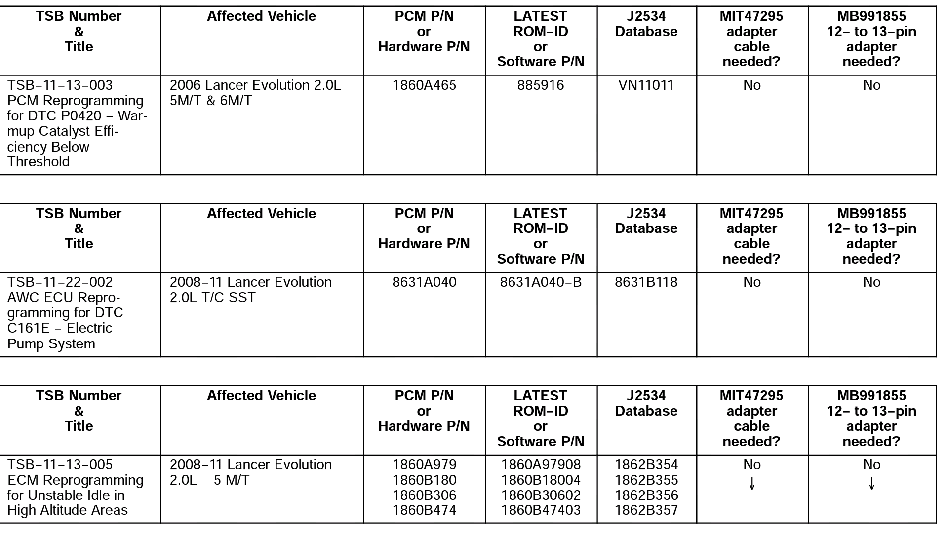

i did some digging, found TSB (tech service bulletin)
Apparently Mitsubishi did have release another rom for 2006 Lancer Evolution 2.0 5SPD & 6SPD.
88590016
Does anyone have definition and rom for 88590016 ?

Old Jul 9, 2018 | 06:36 PM

88590016 is the newest posted above try that one or you can use any j2534 device like openport 2.0 to flash it to stock from mitsu I bet that will work it costs like $40 last time I did it for a single vehicle https://mitsubi****echinfo.com/epacarb/ click j2534 at the top and read the directions
