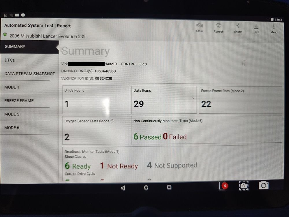

I just put a couple things back to stock & flashed my stockish 88590016 ROM for smog tomorrow when I noticed your CALID is accurate for 88590016.
I've never seen VERIFICATION ID'S here so I thought I'd post a screenshot. I can also upload the Tehpra V7 equivalent when I remod and flash it back if anyone cares.
Just waiting to get off a full tank so I can do that final EVAP monitor.
