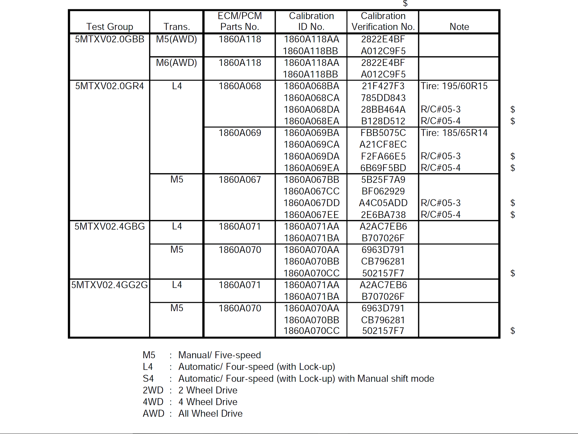

Is there a list of what ecu goes with what CalID/CVN. I bought my 8 years ago tuned and never had the stock rom to swap back to.

You can find everything you need in the documents on this site: https://iaspub.epa.gov/otaqpub/

Thank you, I’m trying to find the cal ID but end up on a pdf file.

I've been digging too. I think it's above my pay grade.

Come on guys…
They are in the pdf’s. I posted a screenshot example earlier in this thread.

This is 2005: https://iaspub.epa.gov/otaqpub/displ...id=4143&flag=1 pg. 123
2006: https://iaspub.epa.gov/otaqpub/displ...id=4163&flag=1 Pg. 112
