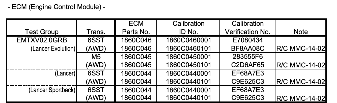

Originally Posted by razorlab
For the Evo 10, the first 8 digits of the CID is the ECU part #
Example from mine: 1860C0450001
Also, if you cross reference the ECU Part # and the full CID, you can get the factory CVN #:
I probably should have asked this a while back.... Where did you get this table from? I'm trying to find something similar for the earlier years.

Came from EPA docs here : epa.gov
Pg.93
Pg.96
Thanks! Looking through it they don't seem to have anything for the 2003-2004 as far as applications. 2005 shows an application, but it isn't found when you try clicking on it.
https://iaspub.epa.gov/otaqpub/displ...id=9510&flag=1
2006 seems to be the oldest model they actually have the "ECM" data on (Page 112)
https://iaspub.epa.gov/otaqpub/displ...id=4163&flag=1

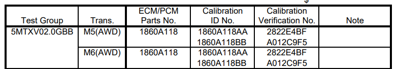

2005 USDM EVO 8
ROM: 96940011 (stock)
CALID: 1860A118AA
CVN1: 2822E4BF
CVN2: B73ED77C
CVN3: 099C6542
Confirmed passes California ARB smog test today 29 May 2021!
2005 USDM EVO 8
CALID: 1860A118AA
CVN1: 2822E4BF
CVN2: B73ED77C
CVN3: 099C6542
Yea I am about to load in the stock 2005 rom too. I had to change the immobilizer code and hex to match my previous tuned rom. Based on the info here this should change the CAL ID but I think I can get it reflashed at the stealership through the recall.
