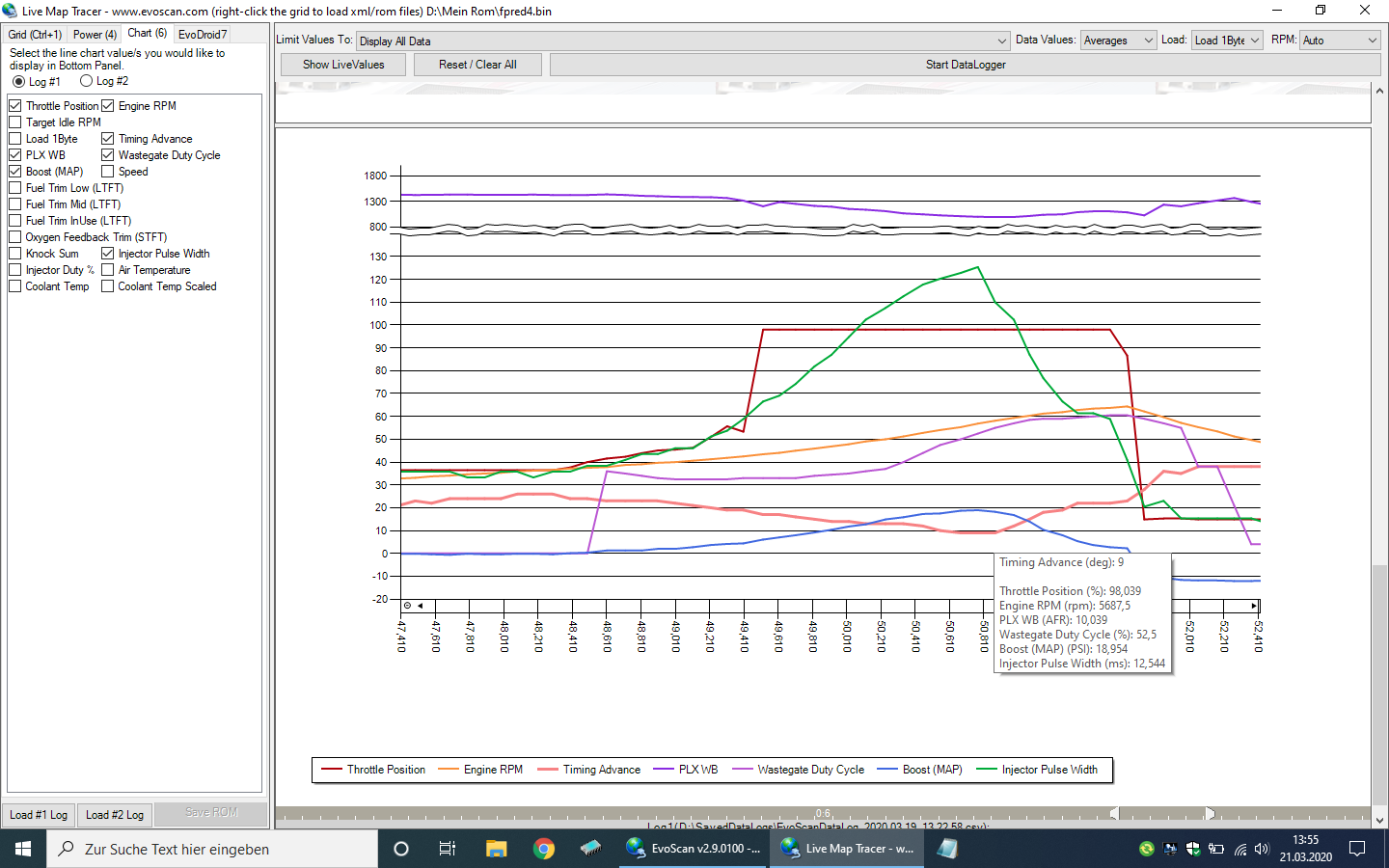

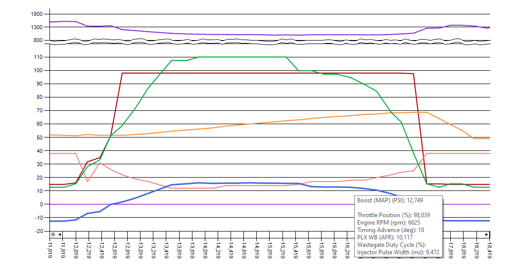

I already installed my fp red during winter. I started with WGDC 0% and BDEL off. The Turbo works fine. I increased the WGDC a little, which works well until 6000rpm, then the IPW drops, Boost drops to zero at 6600rpm, the maximum load is 240. I use x1 Fuel/Boost cut, the value are set on 300.
Does anybody have an idea, where the problem is?
Picture 1 – WGDC 0% - Boost at 6500rpm is higher than WGDC 60%
Picture 2 – WGDC 30-60%
Thanks and best regards

Log your 2 byte load - your probably hitting 300 load and getting fuel cut

I did a Boostleaktest. Three little leaks and my MR BOV blew off early. I changed my bov today and closed the leaks. No change. I already drove with x2 and max fuel cut. No changes.
I use 2byte to 1byte Load Factor 1.2 with Evoscan and log Load 1Byte with Factor 1.2*x. There’s something wrong with that?
Attached my log and rom.
