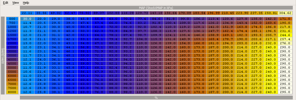

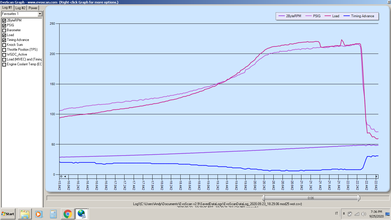

Car is on tephra V3 (53050312), MAF scaling to 65536 everywhere because the inlet pipe is very big, and the MAF at low rpm is very unstable, So it is a MAP based Load car now.
Screenshot of actual MAPcalc and Load logged in evoscan. Have someone seen something like this before? The load drop between 4500 and 4800rpm, Haven't tried at high rpm yet.

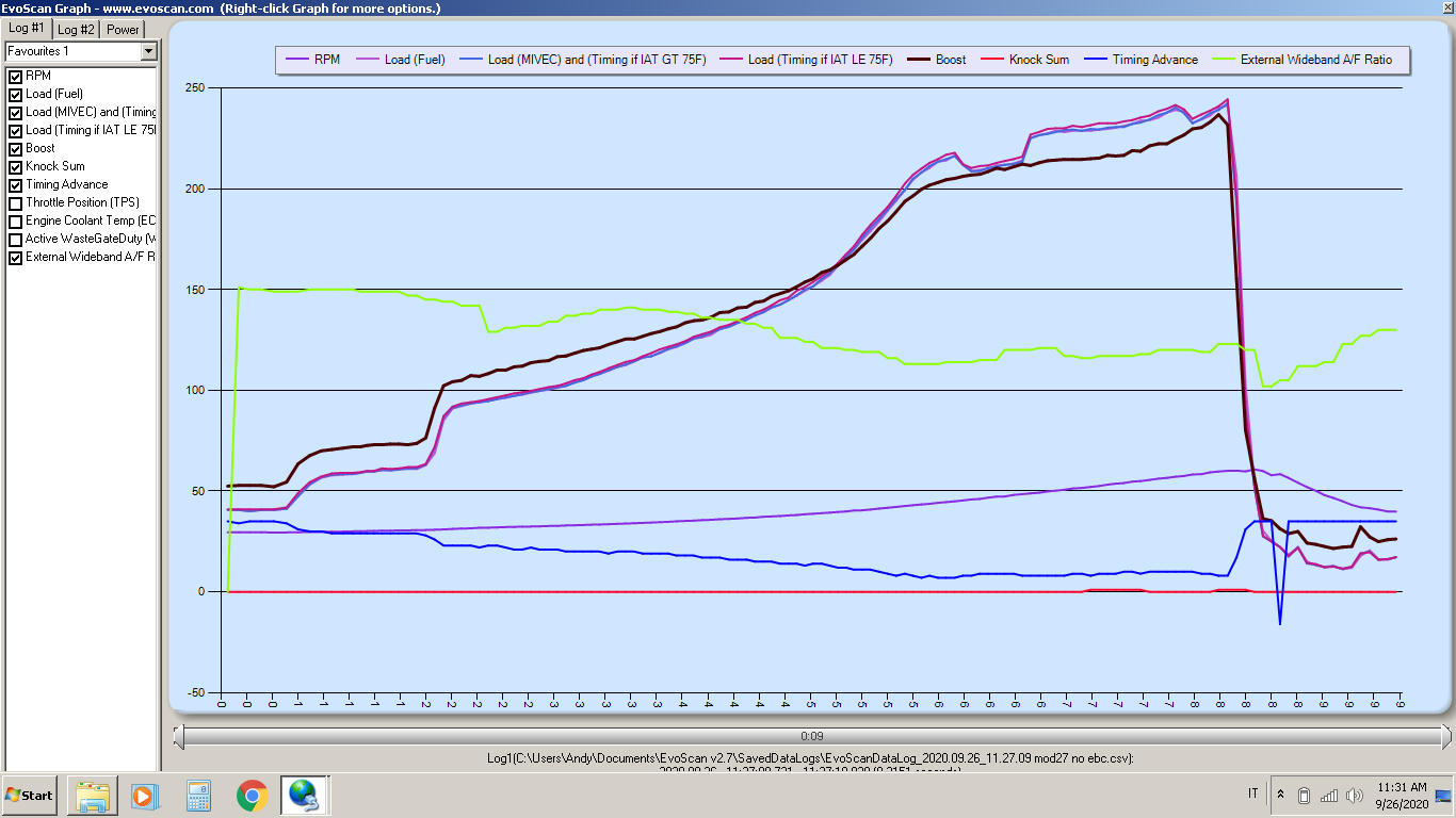

6000rpm run

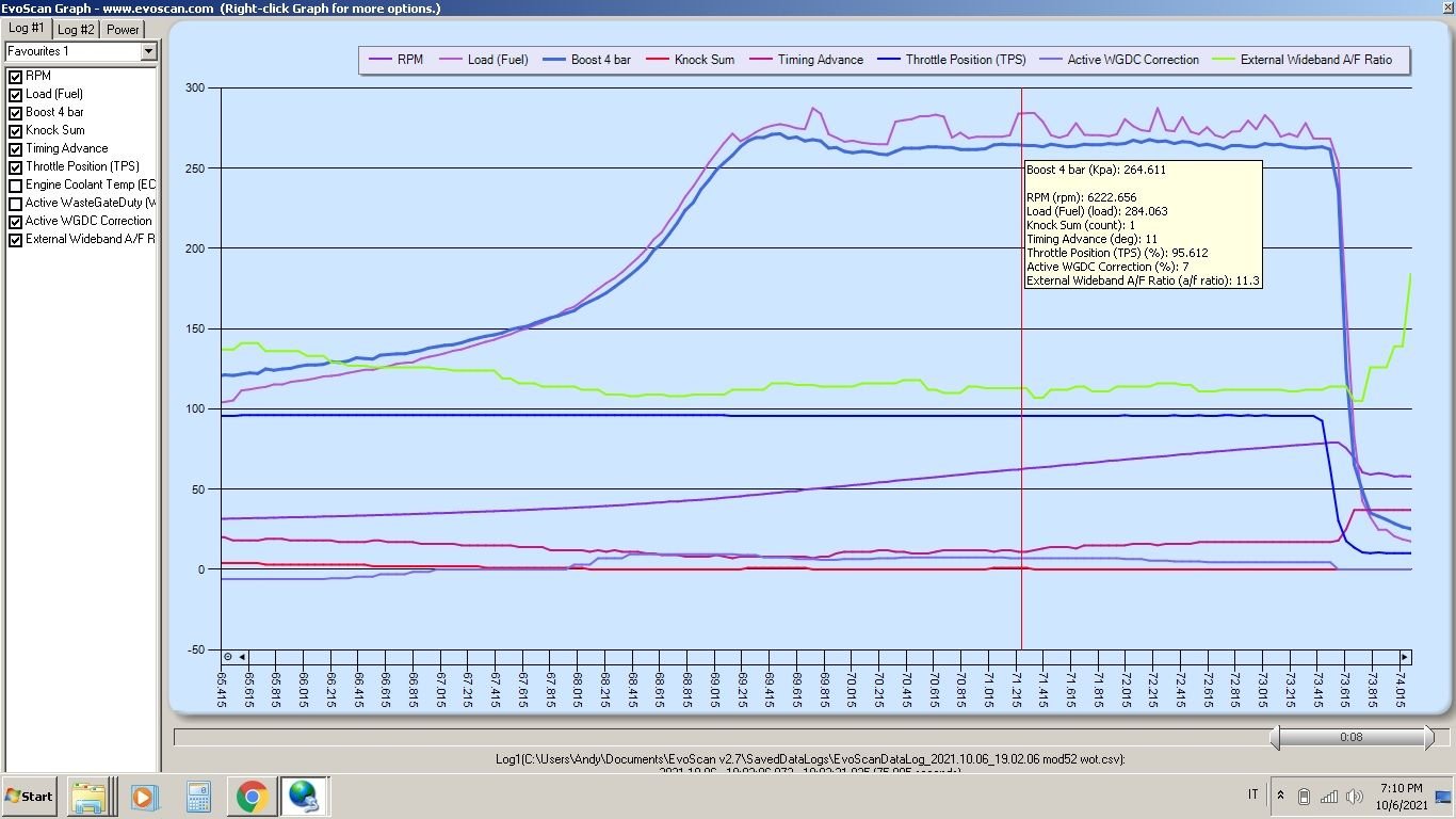

One year later and another turbo setup, same problem, never solved. This is a WOT pull, my mapcalc tables past 110Kpa are exactly the same , MAF tables to 65536 everywhere.
I dont understand! The pronlem is very visible also in part throttle runs
