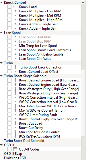

Ok thanks again to all who have replied! Here is an update as to what I have found out so far. I was finally able to open and view some of my maps! When it opened before I noticed in the task info box that it said "Unable to find parent metadata evo7base_20081101". I did a little searching on the forums and found that someone just had to add _20081101 to the end of the evo7base definition. Turns out mine didn't have that so I added it and I was able start viewing some of my maps. That runs me to my next question. It seems like there should be more maps available to view than I have. Can you guys tell me what maps you have available to view for your evo 8 in ECU flash? I will attach screen shots of the maps I am seeing. Again, my user level is set to advanced to it shouldn't be hiding stuff from me due to that.
