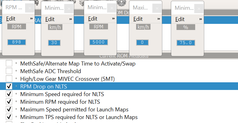

I am using these settings with amazing results.
I shift right @ 7k and it drops to 5900-6000. Holds 10-12 psi.
