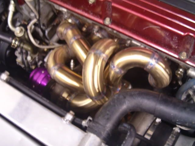

I just brought my car down to RS motors in Burnsville MN.MUSTANG AWD DYNO!!!!!E-85--- 30 psi 465hp 410TQ** Reads 12% lower than a Dyno Jet 2.0L Eagle/ Wiesco comboStock Head/ Manifold/ TBCams HKS 264'sStraight Line Specialties Turbo kitBorngwarner s256Small runner ss manifold3'' downpipeSLS FMIC, Piping1200 cc InjectorsStock ECU, Stock MAFStock Ignition w/ bpr8es Plugs gapped .022Full blown dual fuel pump ACT ClutchI drove it to a 11.3 @126* ( Should easy go 11.1's)
What do you guys think?

I got it from Straight Line Specialties !! If You call them you can buy one too.. I dont think they offer a whole turbo kit on their website but they should. Right now on my car I have the smaller runner manifold I will see if I can get some pics up for you. The purpose of the smaller runner manifold was for quicker spool and more TQ.. I wish we could dyno back to back with the bigger runner manifold..

Thanks! I think this is a great set up for the street and weekend drag racing, autocross, road racing.. I love the spool up and power.. Next mods are Cams ( kelfords) , COP, twindisk, and Ported Intake manifold.
SLS thanks for posting that pic.. its hard to see that the Dia. is smaller than the rest of the manifolds out there ie. fullrace, Peakboost, DTM, ETS. Im not saying the smaller Dia is better but it works..
