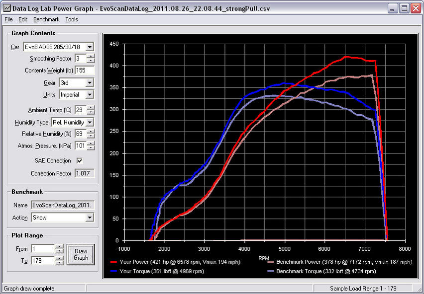

Here's a test case showing the power gains I unlocked just switching to E85 and redoing the tune, all other mods being equal (24psi on both tests).
Mods are:
BBK-Full ported @24psi
GSC S1 cams
QTP 3" downpipe dump exhaust
ETS 3˝" intercooler
ported/coated exhaust manifold & Megan o2 housing
Vibrant cone air filter
Nisei licp
PTE 1000cc injectors
Walbro 255 fuel pump
421hp / 361tq
That's +43hp +29tq (about 11% peak gain)

This is very revealing. Exactly the kind of test I like to see - apples to apples.

+1 ,,, nice test!

Good stuff! You could probably turn up the boost a little more on the E85 and get even more out of it.

Yea, I know I can. I gotta test this at my autocross track to see if it's too explosive for how tight of a course we run. Otherwise, I may have to detune , or start attending bigger tracks .

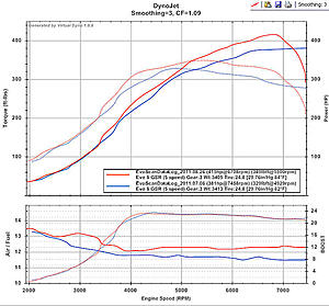

good comparison. can you post your results using the below VD?

I use both of these dyno programs when I tune, however, I prefer DLL in some ways. I'm not fully convinced on VD's accuracy. For instance, VD's 5250rpm crossover point isn't even the same on both lines here. Also, when I chart graphs in excel using the raw data logs, the boost plots at spoolup are much smoother looking than VD's.

It looks like you could stand to add a degree or two of timing from 3000 to 3400. Maybe interpolate?
Very nice results!

1.08 was my least favorite version of VD. The new ones are outstanding though.
