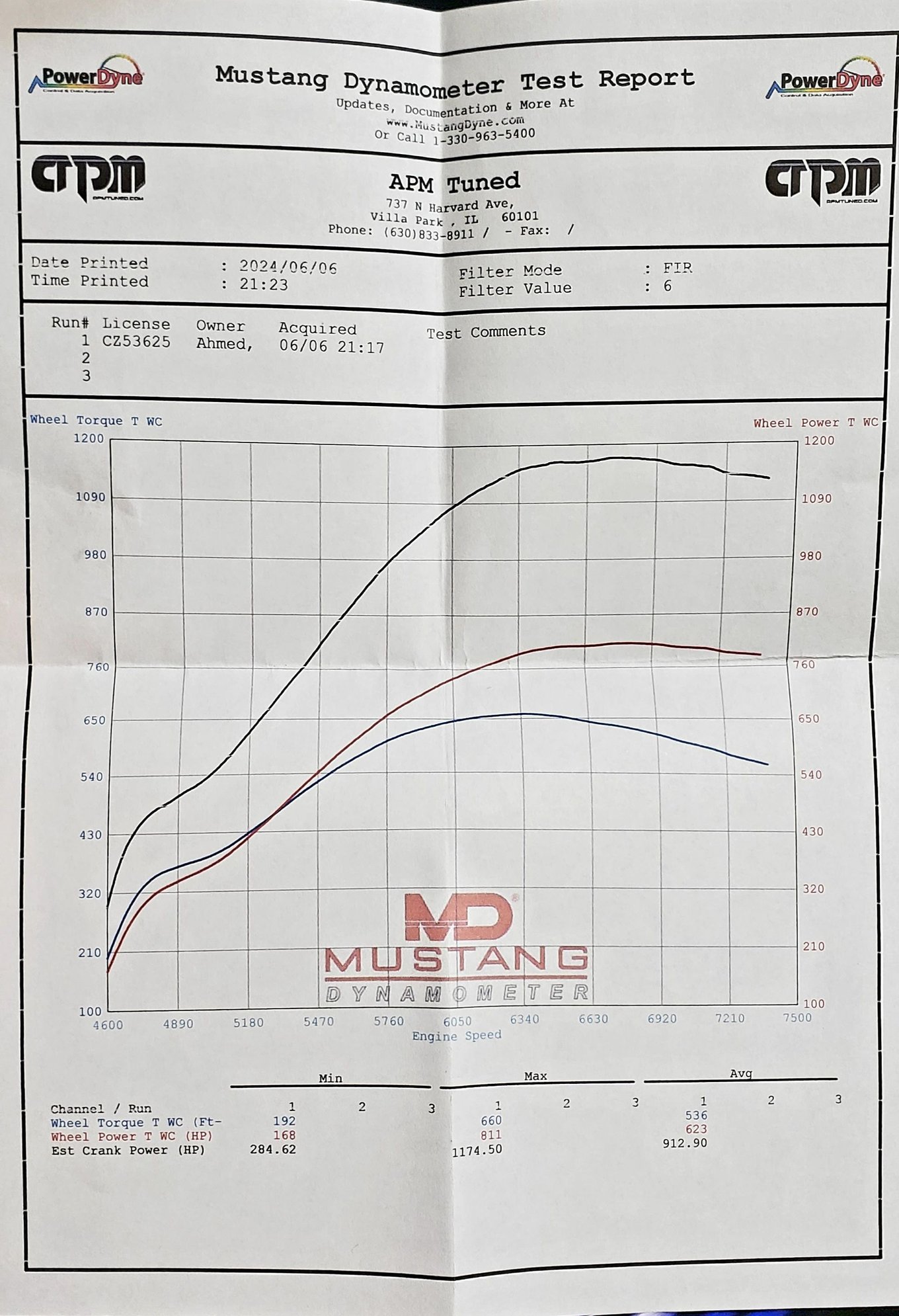

UPDATE: Installed a new AEM map sensor and took it to the dyno. I had a little mishap on the dyno during the last pull at 46 psi. The car pushed through but my 18 tooth trigger plate hit the crank sensor. I'm currently installing the Kiggly 12 tooth trigger kit and will update later this year. The car made 811 whp and 660 wtq. As stated in other posts, a 4 inch intercooler, ported head, intake manifold and some 2600 injectors will be needed moving forward. Updated dyno sheet below.

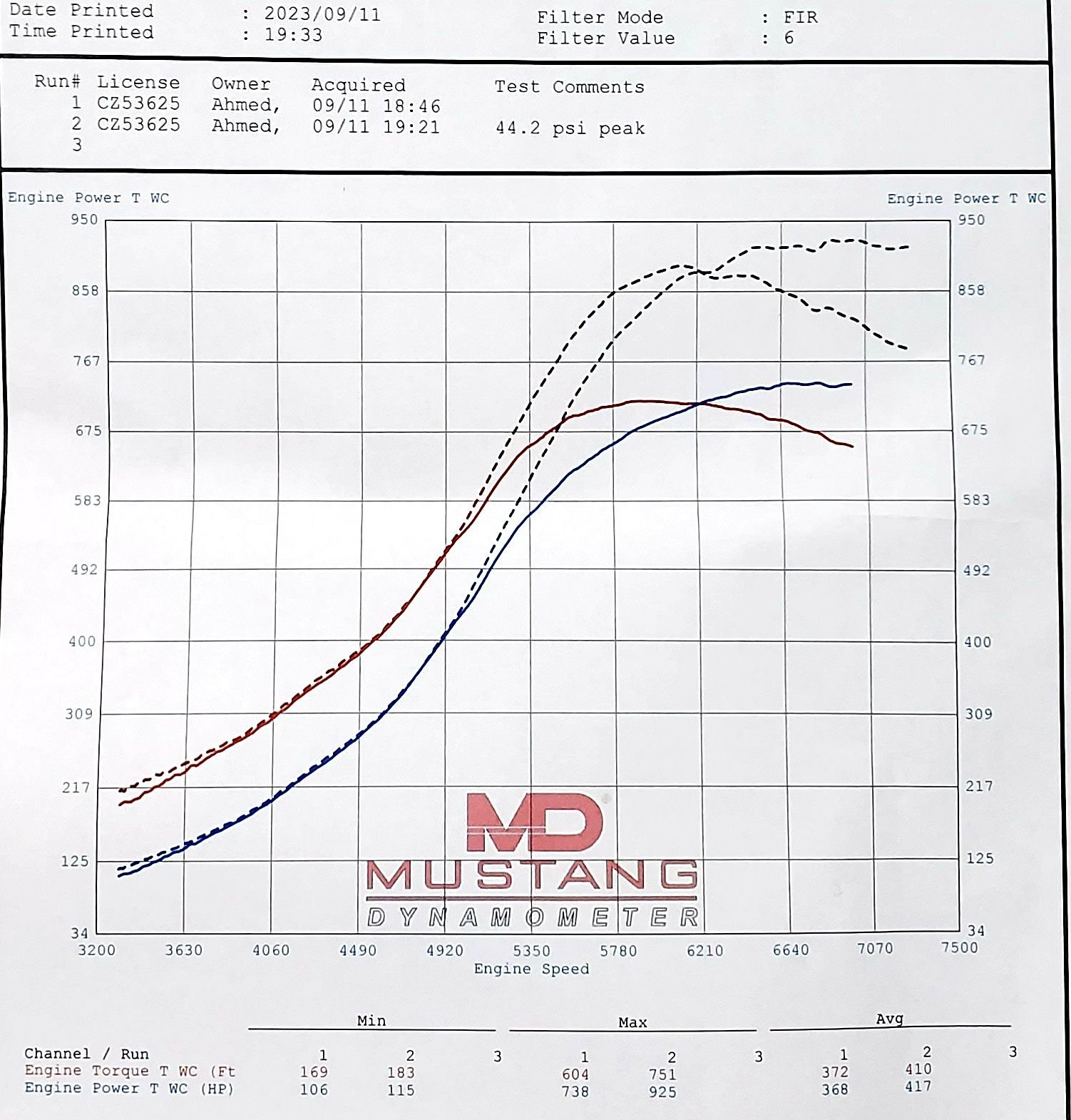

I decided to post this for anyone who wanted to see more results on a precision 6870 with a 4g64 engine. I searched for a while and couldn't really find anything on power and spool. I am definitely loving this setup so far and the car feels insanely responsive on the street. We ended up maxing out the MAP sensor on the Link G4+ so I was limited to 44 psi. The car also retains the factory AC for those summer months. Next up is to get a new a new sensor and go back for another tune. Let's all pray she holds together!

nice figures. why are you not reviing it higher?

Its a 2.4L engine so it can't rev as high as a 2.0L.

That has since been adjusted once the finalizations occured with the tune. I rev to 8k now but it was dialed slightly back by 1-2 psi due to the limit of the map sensor. The graph gets shaky at the 44 psi limit. As said above though I can rev a little more but for reliability and logitivity purposes we left it at 8k.
