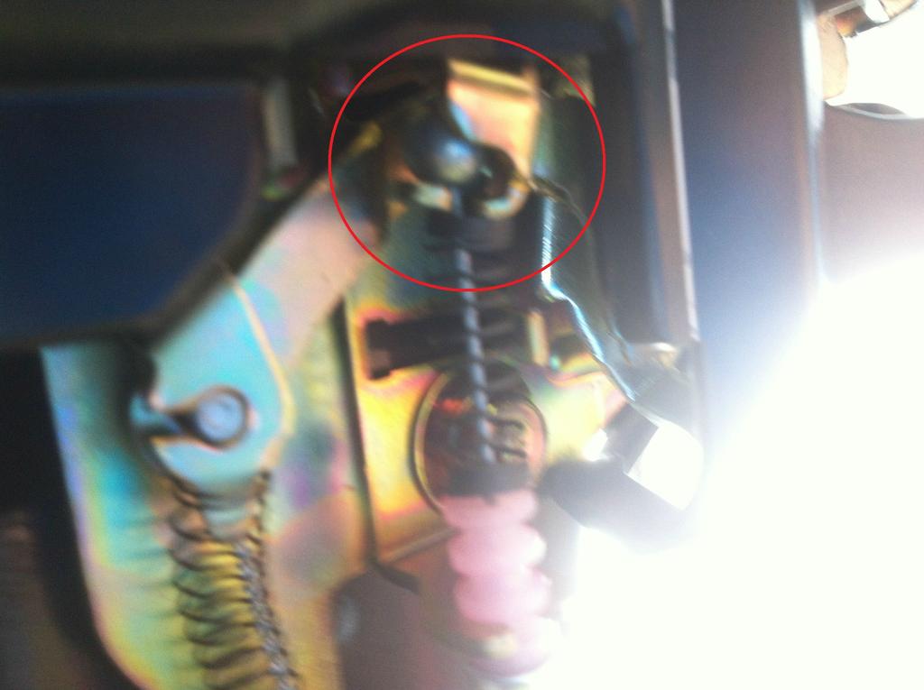

Just picked up another Evo 8, and the previous owner disabled the trunk latch (pull handle by the driver's seat) for some reason and I can't figure out how to reconnect it.
I've searched and came up with only how to disable it but not enable it back. The tension/torsion bars seem to still be in place. Thanks in advance.

I took a look at everything again and nothing seems to be out of place

Figured it out, there is a little metal ball thing connected to the spring that is supposed to hook on the small hinge near the lock, it was disconnected prior:
For anyone wondering in the future

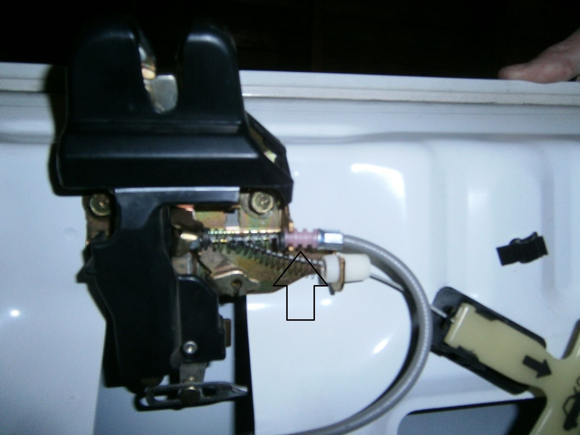

I know this thread is old, how do I get the pink think out of the metel clip with out breaking it
Old Nov 22, 2021 | 07:51 PM
@thepoint4life23 If youre referring to that convoluted plastic bushing, you can remove with a finger.

Thanks, I didnt want to push to hard and break it.
Old Nov 23, 2021 | 06:24 AM
Ive changed my trunk more than a few times & so far that part has lived through it. Just be careful & try & wiggle it out straight w/out prying on it too much
