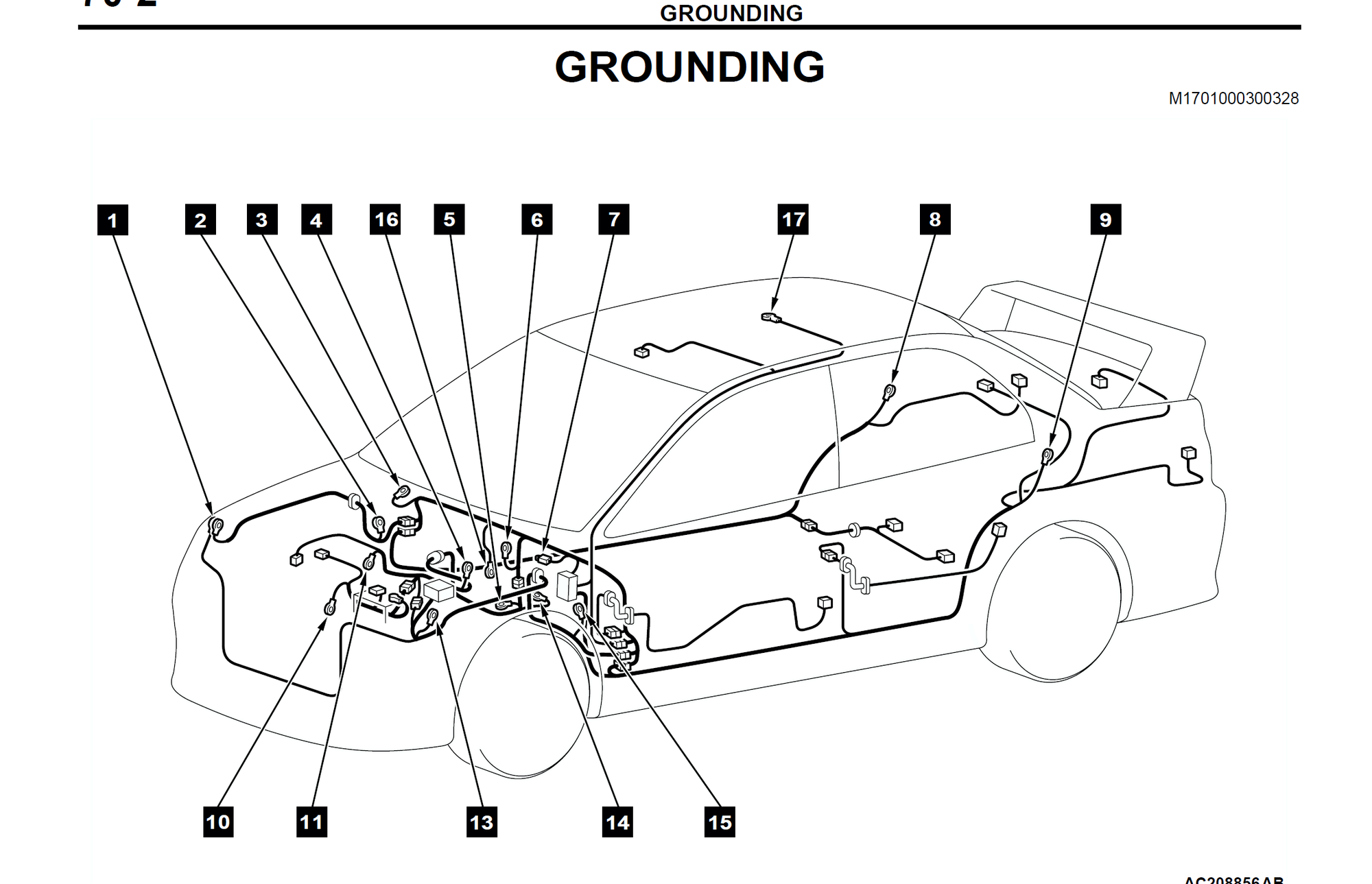

Any ideas of good places to add extra grounds? Should I just replace the ones I can with thicker wire? If it helps at all I’d like to do it. It’s a night and day difference after I did all of this. I bet with extra grounds it’s be a lot better. I’m hooked!
What I like to do is add one big engine to chassis ground, and then wire as many other chassis grounds as i can to that point. Group 70 (Component Locations) of the Factory service manual shows where every chassis ground in the car is. It wont be practical to get all of them, but the under hood ones, as well as like the ECU/HVAC ones will be good to try and get. Since you have the battery in the trunk, I would go straight from the fuel pump negative to the battery chassis ground for sure.

The fuel pump negative? That must be 8 or 9 in that picture?
Yah i think thats right. What I did, and what I would advise you to do though is run another negative for the pump. If you upgrade the positive you also have to upgrade the negative. You are at an advantage having the battery so close to the pump, I would go straight from the pump harness connector to the battery chassis ground.
