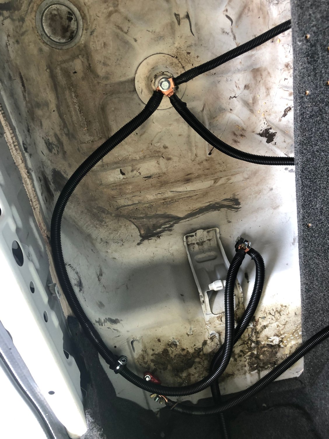

So I ended up tying the rear grounds into the battery ground. Check it out...
That's awesome! Your cars on its way to becoming a Faraday cage
