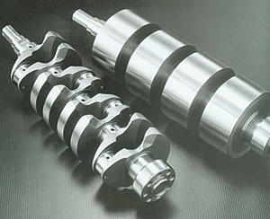

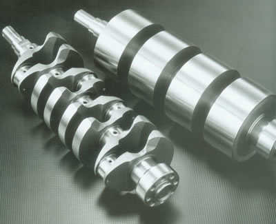

the tomei kit is only guaranteed to last when you buy 1 of their genesis or derive motors
Who gave you that info ?? Tomei, Jun cranks are not 4G64 cranks. They are made from forged billet stock and are drop in with the proper cylinder work.
Old Feb 1, 2005 | 07:29 AM
  #47
11secEVO7's Avatar
iTrader: (37)
Posts: 1,889
From: Miami
Talking
Originally Posted by pyrovice
800m whp, is that going to be the fastest evo around?
nah..rc developments 930hp......
dont forget them
Old Feb 1, 2005 | 10:01 AM
  #48
spoolingEVOx's Avatar
Posts: 674
From: Jersey, USA
just out of curiousity- when you say forged billet stock, do you mean that they're made from the ground up as a forged cam or that they're just a forged 4G63 cam?
Old Feb 1, 2005 | 02:21 PM
  #49
value's Avatar
Joined: Dec 2002
Posts: 2,777
From: Evergreen state
Yep have watched them mill their own cranks/cams/pistons in the shops.
