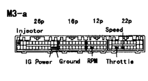

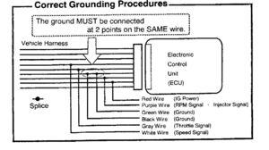

Check your connections, especially your RPM and throttle splices since it sounds like that may be the issue with the behavior your describing. Also make sure you have your grounding in the correct order.
Additionally, don't make any of these connections with wire taps/vampire connectors, they add a lot of resistance to the splice which could be the problem as well. I soldered all of mine and works great. You can also melt the jacket at your splice point with a soldering iron and wrap the connector wire around the bare wire, then tape it firmly. I wouldn't use a whole roll though, you'll be tapping it again for other mods at some point
Also, verify that you've used the correct harness diagram. I'd think the AVC-R would not work at all but with the rpm issue your describing, it could be that you've tapped the wrong wire so its reading an incorrect voltage.
I would double check your wiring first, you can also use the AVCR sensor check but I'd start with the physical here and work my way up.

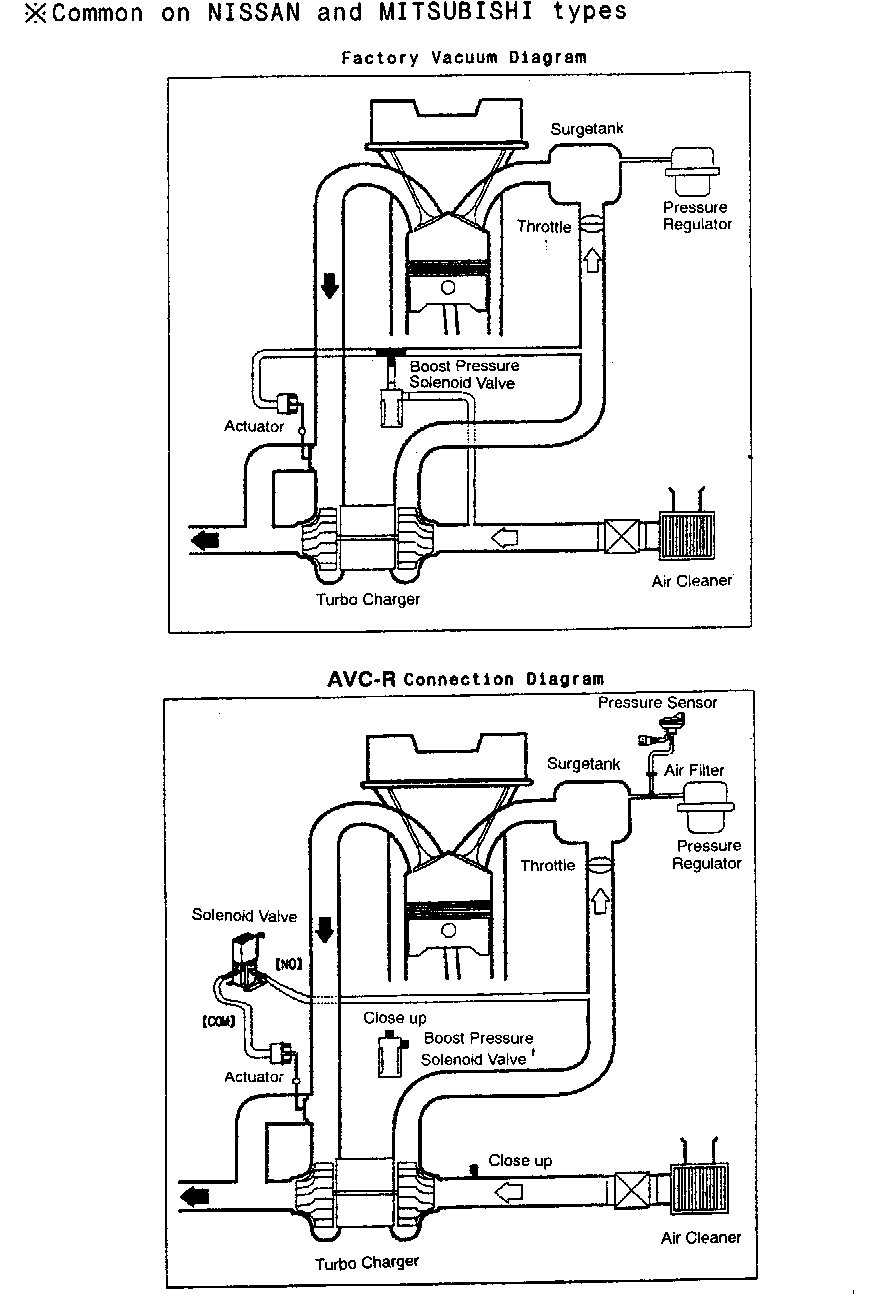

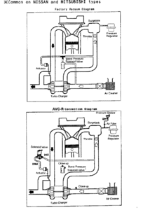

Attached Thumbnails AVC-R controller problems-avcr-wiring-diagram.gif   AVC-R controller problems-mitsu-m3a-avcr-harness-info.gif   AVC-R controller problems-sensor-check.gif   AVC-R controller problems-avcr-vacuum-diagram.gif
