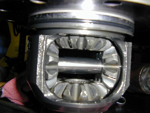

The spider gears are still in good shape. Here is a pic I took while dismantling it last week.
I have never seen a diff for sale before so I don't know what it is worth. Maybe $250? Does TRE sell diffs as we could use that as a baseline.
I could have it Cryoed for a little extra if you are interested. Let me know and I will find out an exact price -- I am having the whole TC done when the Quaife arrives and adding the diff to my batch probably wouldn't add much more cost.

Old Mar 12, 2005 | 06:56 PM
EVOnoir's Avatar
Posts: 90
From: E-town
i think 250 is about right. we are diagnosing it tomorrow. hopfully its this because we can fix relatively easy.
