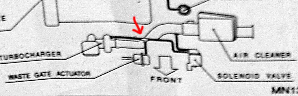

There is a white sticker under your hood, on the driver side. It has the correct locations for the stock hoses, one restrictor pill should be 1-2" from the boost solenoid l closest to the harness, under the air box, in the line going back to the WG and Compressor. The other restrictor pill is 1-2" from the compressor housing, in the shortest hose of them all, from the compressor housing to the "T" fitting. The hose from the black intake pipe wil go directly to the farthest side or the boost solenoid, no "T"s or other connections. You should be able to squeeze the hose to feel for the restrictors.

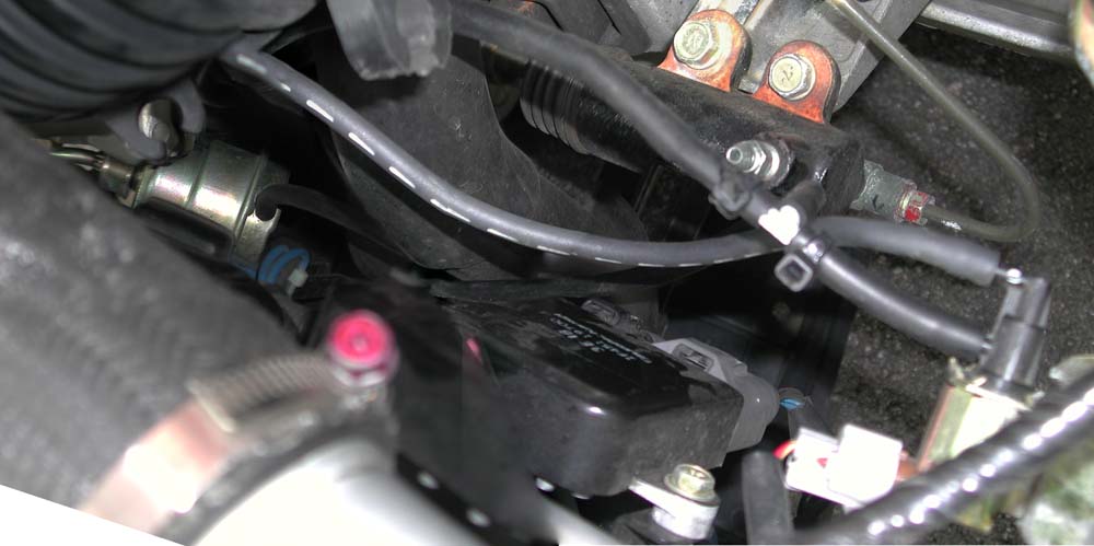

I wound up at home today, so I pulled my air box and looked at the hoses as they have been since the dealer did onto them. No color codes, and by touch, probably no restrictor pills at all. This should be a slightly hacked photo of what I have now, made of 3 photos. The dealer's zip ties on the replacement T connector can be seen:
Will the replacement hoses need zip ties? I checked the hoses against the diagram, the placement looks correct.
