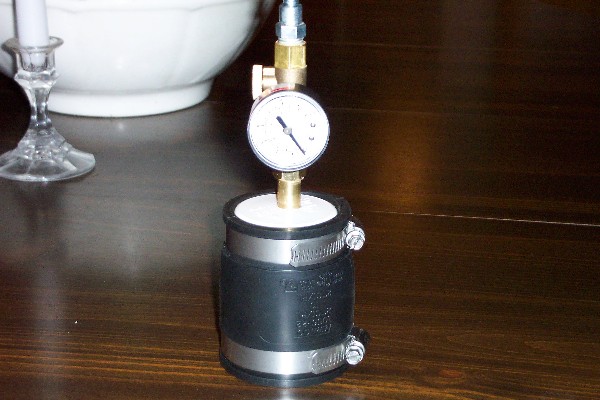

I made a very simple pressure tester with a stock IC coupler, a 1/8" npt tank valve and 1-1/2" ID PVC cap from Home Depot. So far, I've found that the flange on my Buschur upper IC piping is warped. I tried putting RTV on both sides of the gasket but that didn't fix it (and I let it dry 24 hours too). Then I removed the gasket altogether and tried just RTV -- bingo -- fixed. Then I could hear the next loudest leak. A hole in a weld in the corner of the core of my Buschur FMIC. Patched that with a tiny bit of RTV (it was very small). Then I heard a distinct hissing and felt a stream of air from where my Buschur lower IC pipe meets the turbo. This really annoyed me because that pipe already fit very poorly and I was VERY careful not to warp the flange when I installed it. Well, I reached up and was able to stop the hissing by putting my finger over a pin hole in one of the welds at the top of that pipe, so the leak was from a weld, not the flange being warped. I just JB Welded that up and I'll reinstall it tomorrow and continue testing.
All I can say is that if you haven't pressure tested your car, you should. I did everything right on my car with t-bolt clamps, RTV at leak prone joints, clamped or zip tied vacuum lines, etc. I didn't have leaks at any of those usual points, but these defects in my parts caused leaks that I would never have suspected without the tester.
Here are pics of the tester, the package for the tank valve that I screwed into the PVC cap (after drilling and tapping the hole with a 1/8 npt tap from Sears) and my BOV after sealing it with RTV and no gasket. I hope that the patch on the weld for the upper IC pipe is the last of the leaks, but you can't tell until you patch each one as they get progressively quieter.
Hope this helps someone.
Pressure Tester Pic
BOV flange sealed
Tank Valve 1/8 npt package

Rich,
I tried the same home made kit and can't seem to go beyond 13psi.
Any suggestions?

What do you mean that you can't go beyond 13 psi? The tester is leaking? If so, where is it leaking?
BTW, the clamp on the PVC end is just a regular hose clamp. I've had it up to 28 psi with no leaks (at the tester).

$25 HomeDepot Job!!! Good to atleast 30psi that ive tested. Built in Regulator with Compressor hose connection.
Thing is []D [] []V[] []D
