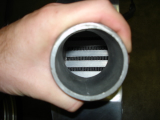

Originally Posted by Stealth Ag
I didnt take those pics....i found them while searching on Evom.....so the angle/distance/light quality isnt my fault
XS Power....12 fins per row
AMS.......17fins per row
So probably some better cooling going on there, flow is negotiable.
As for wether or not you need an FMIC upgrade...just like everything else on the evo, you dont need it....but if you want it, your gonna buy it.
Now the question....5-fins per row worth $500 more?
The endtanks are the same, the bar height is the same, the only difference besides weld quality (which is subjective) seems to be the fin density& spacing
there are more than 12 fins per row on the XSP ic. the picture got cut off by the inlet pipe. you can see it in this picture which is the original picture.

Originally Posted by sonicnofadz
I resized the images a bit, and brightened the XS shot...see for yourself!
The AMS core:
Then XS power core:
Looks to me that the AMS core definitely has a higher fin count.
Also keep in mind what was said above by Mitsuorder, the bar sizes are different between the two cores.
I dont know who posted these. But the xs power core I have here (109$ e-bay) has the same internal design as the ams photo above. The turbulators look indentical to the ams design one.

The internal fins appear totally different, that's what is going to determine how good the core is. In short, fin configuration is counted per inch, not row. The AMS has a louvered bump fin and the XS Power appears to have a standard square fin with nothing to "turbulate" the charged air. The less exposure to heat exchanging elements, the less heat will be extracted from the charged air. The XS Power could also have a split internal fin. We just need better photos.

Ok, I snapped some close up shots of my XSPower IC, looks good to me...
The AMS core: (same as posted above)
my XSPower core:
sorry for the huge size.

Looks like a split fin design on that second shot.

My core looks like the one alwaysinboost just posted. Actually the xs power design looks to be superior to the ams core. The turbulators have more surface area where they attatch to the tubes. This allows better heat transfer. Also there aren't as many blocks on the ends, just more turbulators.
The downside to the e-bay core is the 2.5 in/outs are cast. They are thick so they wont flow as well as the ams core.

my endtanks are welded sheet metal. It looks like the in/outs are just 2.5" aluminum piping welded in. It probably has the same ID as any IC pipe.
I hope this puts the IC issue to rest but I don't think it will. some people just don't believe poop smells like poop until the smell it for themselfs.
I think its funny that AMS or any other IC vendor/manufactuer didn't post up any ACTUAL data stating why the XSPower is was crap and their IC was superior and worth the extra price. Instead they all just chose to bash the way it was constructed.
are you sure the endtanks on your XSP IC are welded sheet aluminum, because from the picture it looks like the outlet is cast. you can see the casting marks on it. can you take a picture of the entanks from a farther distance.
btw, the inside of my IC core looks like yours, not like the first picture someone posted.
