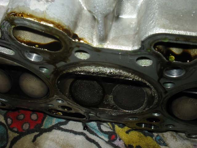

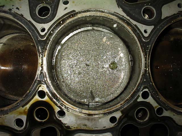

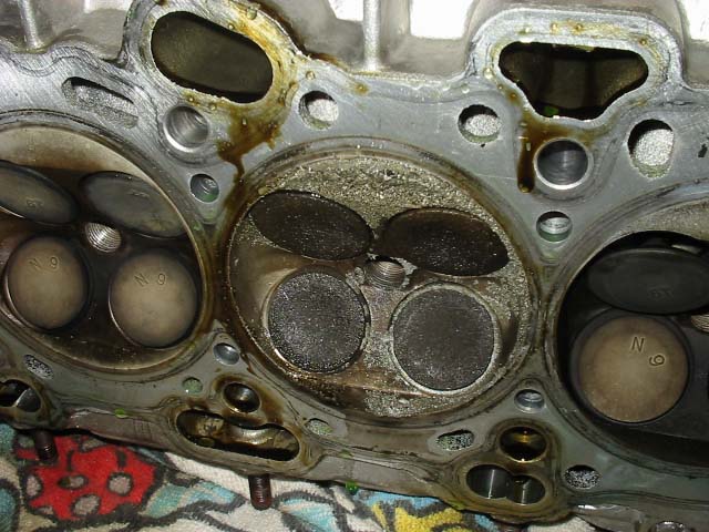

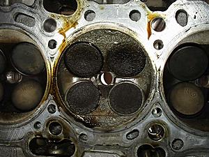

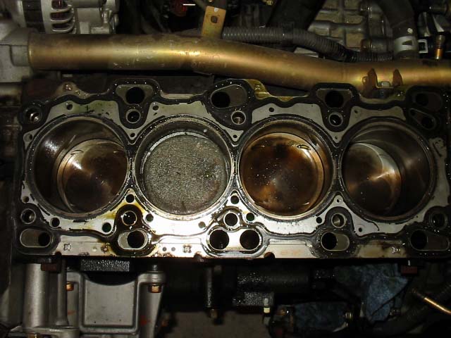

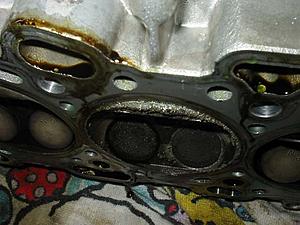

The number 2 piston underwent some detonation. I am suspecting fuel starvation to that cylinder. I'm sitting at 56,000 miles.
I'm going to go through TurboTrix for all the parts and machining. My plans are to stick with the 2.0L and build the bottom end and head to support 9K rpms and upwards of 600whp. I'll have to stick with the stock turbo for now, but I plan to get the most out of it. I'll be swapping over to a 10.5 hotside and maybe doing some porting of the exhaust manifold.
I had been saving up to get the TT turbo kit, but looks like my engine build is moving up on the schedule, HAHA. You have to always look at the postive side.
Attached Thumbnails Engine Blew!!-101-0106_img.jpg   Engine Blew!!-101-0107_img.jpg   Engine Blew!!-101-0108_img.jpg   Engine Blew!!-101-0109_img.jpg   Engine Blew!!-101-0110_img.jpg

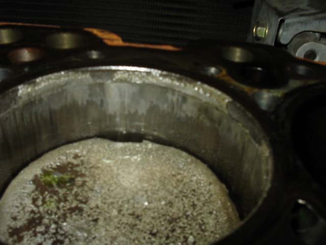

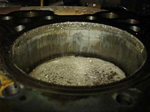

Couple of more.
Attached Thumbnails Engine Blew!!-101-0111_img.jpg   Engine Blew!!-101-0112_img.jpg

hmm, any reason why the motor went, that doesn't seem like a whole lot to be pushing this motor past its reliability?
Old Nov 21, 2005 | 10:12 PM
timzcat's Avatar
Posts: 2,691
What do you think caused the fuel starvation in that one cylinder?
What are you using to tune the car? What injectors are you running in the car?

Man I hate reading these kinda posts but I'm glad your staying optimistic. So was it an injector failure, maybe it didn't seat right, bad wiring, faulty spring/ball in the injector? I always have that fear for some reason. What fuel mods do you have?

I'm using the stock injectors and a custom flashed ECU. I'm going to send the stock injectors to RC and have them take a look at them. I suspect a bad injector. I want to know what happened before I run the new engine once I get it together. I'm sure nothing was wrong with the tune since I have been running a TT custom flash for almost a year.
