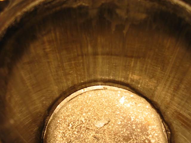

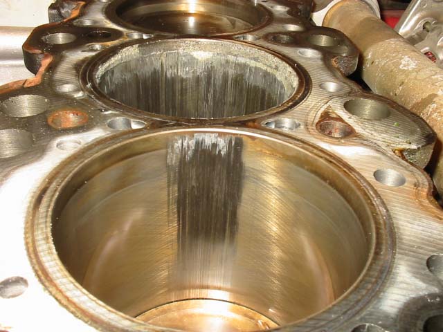

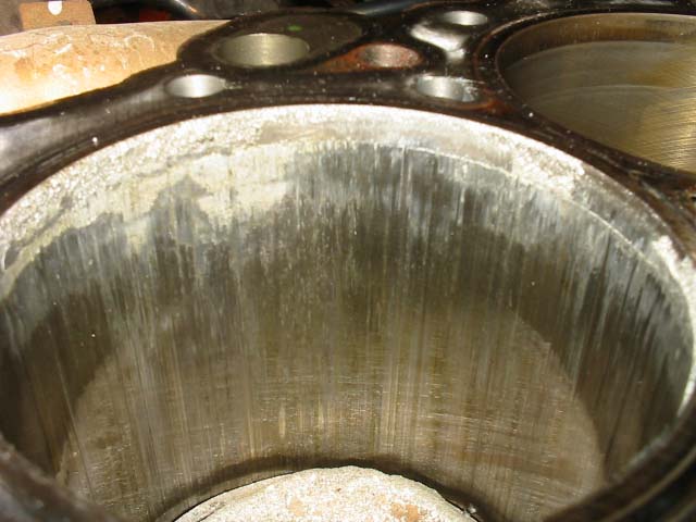

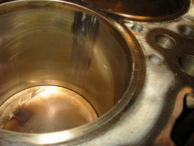

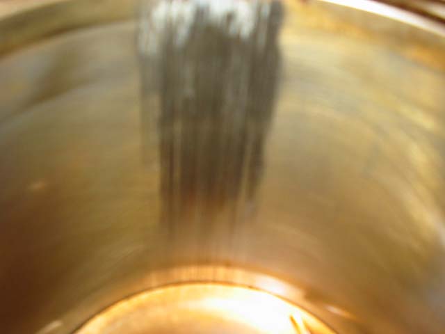

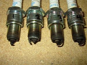

More pics. #3 is scarred pretty bad. I don't know how to explain that one.
Attached Thumbnails Engine Blew!!-101-0113_img.jpg   Engine Blew!!-101-0115_img.jpg   Engine Blew!!-101-0116_img.jpg   Engine Blew!!-101-0117_img.jpg   Engine Blew!!-101-0118_img.jpg
Old Nov 24, 2005 | 12:51 AM
bpclements's Avatar
iTrader: (41)
Posts: 960
From: Oceanside, CA

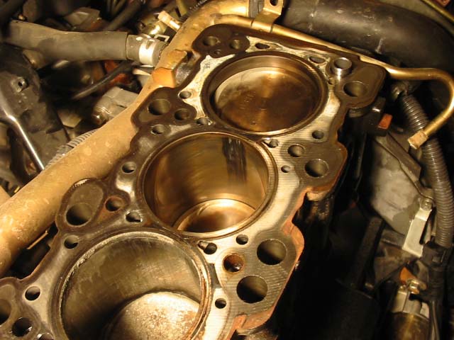

Few more.
Attached Thumbnails Engine Blew!!-101-0119_img.jpg   Engine Blew!!-101-0120_img.jpg   Engine Blew!!-101-0121_img.jpg

Hey Barry have you checked the fuel injectors yet?
Old Nov 24, 2005 | 11:04 AM
nightwalker's Avatar
Posts: 1,635
From: Butt**** Nowhere
at that power level, do you know what duty cycle the injectors are running? You could have maxed the injectors out and one may have just decided to quit. Happens when injectors are overworked.
Old Nov 24, 2005 | 11:19 AM
SaabTuner's Avatar
Joined: Jul 2005
Posts: 274
From: Davis, California
I'm not sure I'd say that's an injector problem. I think it might have been a cooling issue either with the coolant or the oil-squirters for the pistons. #3 is showing obvious signs of overheating.
I would check the oil-squirters for those two pistons.
Old Nov 24, 2005 | 11:41 AM
bpclements's Avatar
iTrader: (41)
Posts: 960
From: Oceanside, CA
I haven't checked the injectors yet. I'm sure that it caused the detonation.
