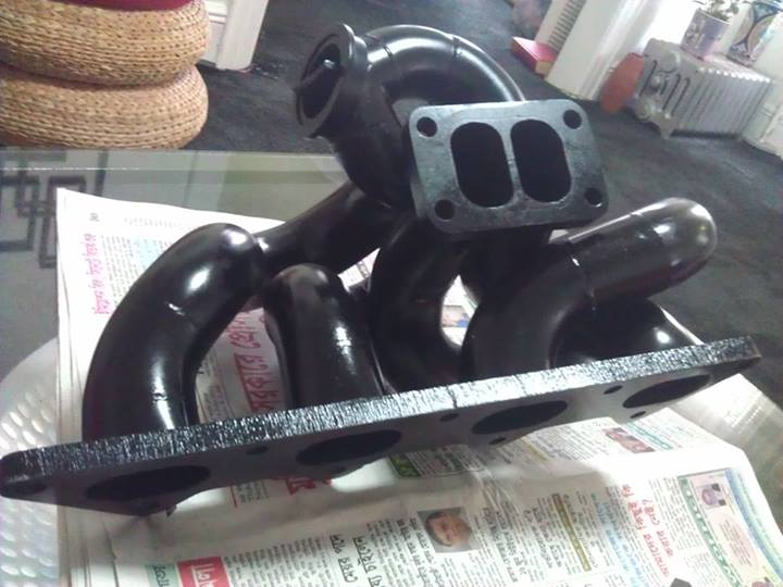

Originally Posted by NoobSybot
i know it says gt3076 but i have a gtx3076
evo 9
stock bottom 2.0
gsc s2 with springs and retainers
walbro 255 and ID 1000cc
mpfab.com t3 twinscroll mani
gtx3076 , t3/ts 1.06 ar 3" vband out
because of the stock bottom the afr around 3.5-4.5k rpm had to be enriched because of the torque this turbo was producing.
i hit 503whp and 425tq at 25psi on dyno jet. also the tuner was surprised on how it pulls on top (being a twiscroll) we did one pull to 9k rpm to see if breaths on top, and it keeps pulling. Thanks to Walker Morgan's mani from mpfab.com, and Atp housing
getting a 2.4 with 10.5 wiesco hd and manly tt I beams built. keeping the same turbo. will post #s

Originally Posted by 94AWDcoupe
can you post a dyno graph? and pictures of your setup?
yes i can, but i dont have pics of it in the car because everything is apart right now for hte 2.4l build.
what fuel? open dump? what compression you going with on the 2.4?
The above graph was done on pump gas. I live in queens and I don't have e85. This was on a single walbro 255 and id 1000. The new 2.4 will have 10:1 compression and also on pump. I am adding walbro 400, same turbo , same cc segmented ceramic (I think stage 3) , stock tranny. Gsc s2 cams , although I want gsc s3 if anyone has. Super tech valves and springs
