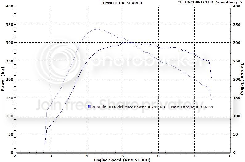

Yah, I dyno at 5500', but I don't post my corrected numbers. You have to post uncorrected numbers, otherwise you give people false information. The SAE correction for altitude is made for N/A cars, not turbo'd cars, so you have to remove that correction and post the base numbers. For instance, if I posted my SAE numbers, I'd be saying I dyno'd 378whp/425wtq, but I really only put down 300whp/337wtq. The drag strip confirms this, as I can only trap 109.xx at the drag strip as of yesterday.
I like seeing the immediate before and after gains, but we can't mislead people with inflated SAE corrected numbers at altitude. For example, here's the same dyno run displayed both ways:
SAE corrected
Uncorrected
Huge difference even at 4500'.
All that being said, I don't know what correction was used or how that works on a Dynapack, so it may not be inflated, but it's still good to post uncorrected ACTUAL numbers in addition to the corrected numbers, especially at altitude.
