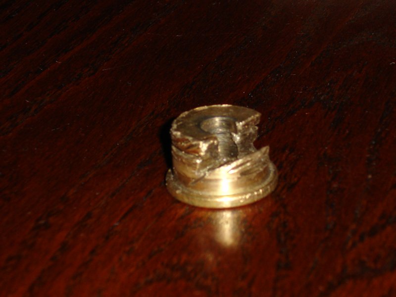

Oh man, that's a big bummer then! The same thing happened to me.
Get it wet with some WD40 and try to work it loose. If it won't budge (not even with vice grips) you'll probably have to cut it off with a dremel like I did.
If you want to see how I attacked it with the dremel I can post a pic later of my mutiliated bushing.
Good luck! Let us know how it goes.

Here's how I got mine off. lol

Originally Posted by naucrx
Sweet dude, glad you got it off!!!
Wow, that's ONE way to do it!
