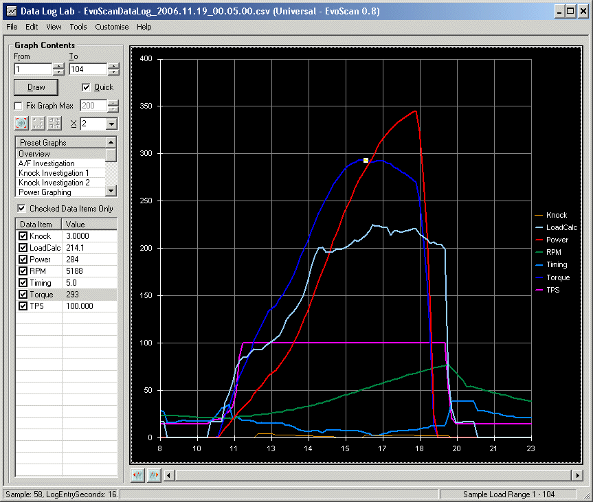

Bryan,
Saying that it is so does not make it so. What the OP is saying does not match the data posted. Here is the dataloglag gif. You can see that max torque, load, and minimum timing happen at almost the same rpm, ie, 5200 rpm. That is laggy in my book.
Look at 14.2 on the X-axis, and 200 on the Y-axis. That's where I hit 21psi at ~3800rpm. That's what the boost controller is set to reach (at least, that's what it was set to reach using the IX turbo on the same upgraded actuator). From that initial boost shelf, it creeps up about 2psi -- offering greater torque/load which peaks at about 5200rpm and then tapers back down to the original 21psi setting. This is precisely what I said in my original post, and I don't believe 21psi at 3800rpm equates to a "laggy turbo." I'm tempted to try a +1/-1 cam gear setting and see how much earlier boost comes on.
I haven't driven the car enough to know if the creep is just the EBC "learning" the curve of the new turbo, or if it's the HP actuator, or if it's just how this turbo works. If there's no correcting it, I'm actually fine with that since the extra boost actually comes on at the perfect time (just after torque peak--where knock is most likely), and tapers before things get out-of-hand at redline.

This data is pretty much useless without a tune I checked out your logs.. timing is all over the place.. 2* at 5200 (or around there) with a peak of 12*.. I would assume this is 91oct gas (may have been stated already).
