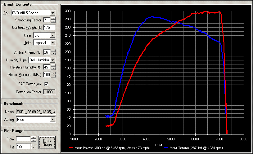

Originally Posted by Spec'd
Not to get O/T... but those are decent numbers there nj1266.
Thanks...Here's my best one. Peak is lower, but the overall curve is better. Notice how the car holds hp up top. I love the stock turbo I am tempted to get 272 cams and tune the car to see what I can get.
