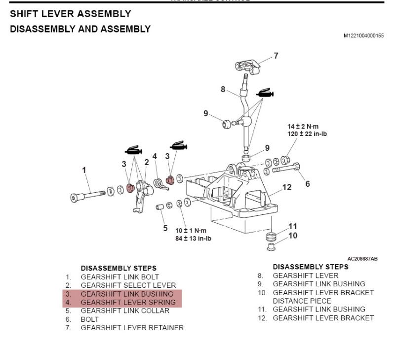

Does anyone have a picture of their shifter assembly before they took it apart?
I am looking at the service manual which should the shifter spring one way but I saw the instruction on the Kartboy site and its shown the opposite (the arm with the jog is at the bottom rather than at the top as shown in the service manual) and I wanted to know how it goes...
My problem is that there is a bit of vibration on the shifter stick and i think its coming from a broken copper busing... which probably broke I assembled it wrong? the vibration is anoying at happens in 3rd and 4rd gear around 4000 RPM

http://www.joe250.com/cars/evo/shortshifter.htm

thanks, kertboy links to him i think
