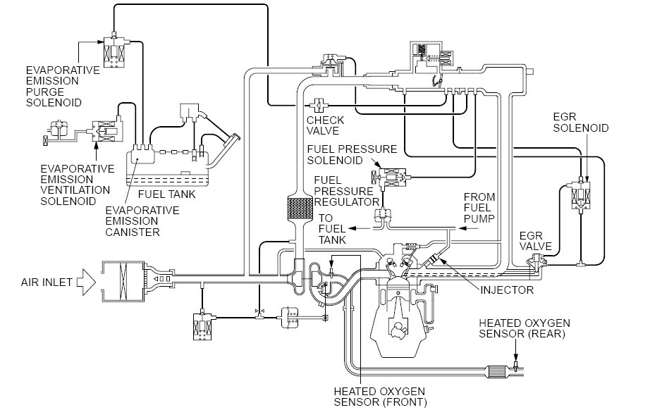

Driver side rear...here you go for visual aid:
