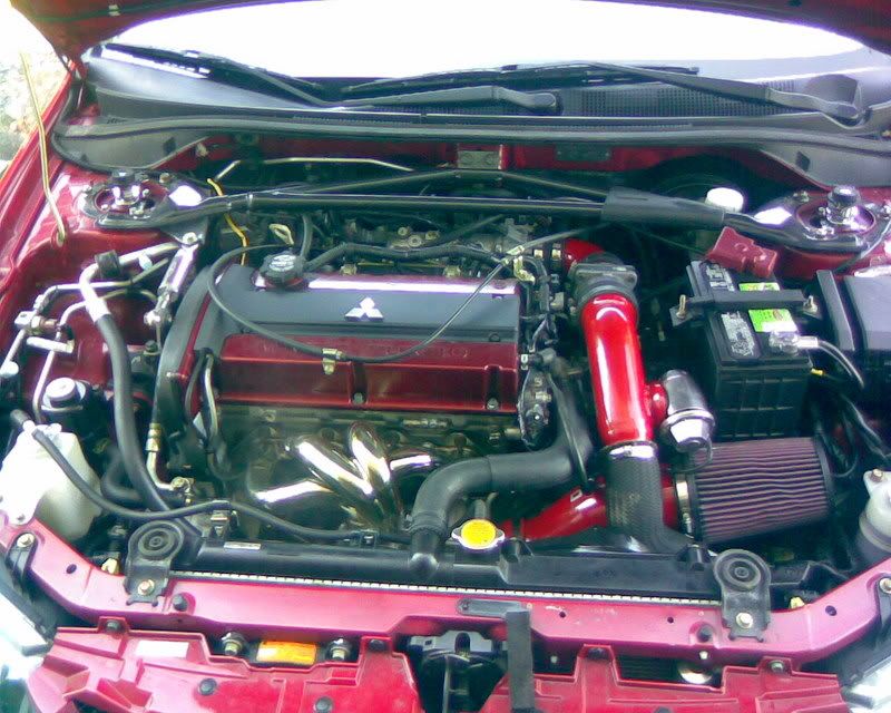

Do you actually know what the MAF sensor does? Your car won't run without some way to meter the air coming in. You have to replace the MAF with something, whether its with a speed/density conversion or a Ford/GM MAF sensor. The easiest and cheapest way is with the MAFT and a GM MAF sensor.
I am using the MAFT Pro with a 3" GM MAF in a blowthrough setup:
Matt, please let us know what gains you saw by switching over to this set-up, as well as any changes in drivability noticed...
Thanks, I have been considering this as well, but only if it was worth the hassle.

I don't know about gains just yet. I'm still tuning and I just found out I need bigger injectors.
As far as benefits go:
I can VTA with no issues.
I have a full 4" intake pipe.
If I blow an I/C pipe off, I can switch to speed/density and drive it without too much issue.
