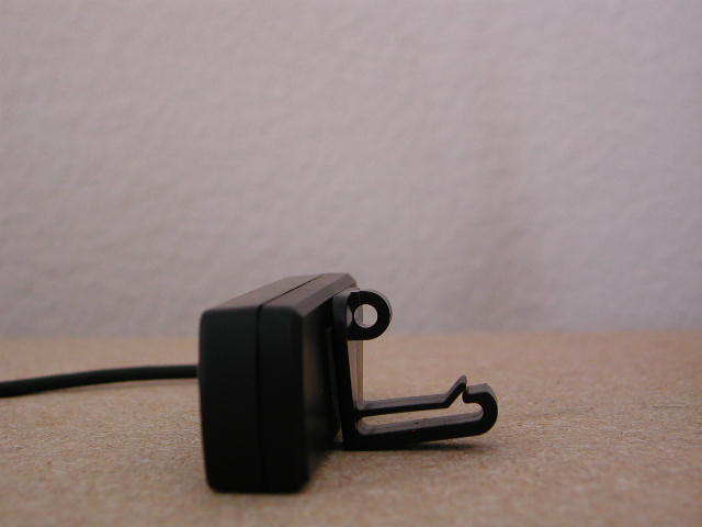

I've got some pic(not very good quality) of the hole that I used for the boost line and the mounting location for the display unit.
I've purchased a cell phone holder that can clip on to the air vent for $1 from a local dollar store. I then mod it and tape it to the back of the turbo timer display unit with the wire running down the air vent tunnel and through a joint between the tunnel. The main unit is then mounted on top of the ecu bracket (behind the glove box. The air tube for the boost guage is then routed through a small hole to the right air vent box (also behind the the glove box). I think the hole is there for the right-hand drive clutch master cyl. I hope the pic comes out good enough for everyone to see.
-Terry

pic of the modded clip taped on the display unit.

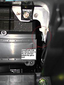

here is the fire wall hole that i used (view from the engine bay)

Also, to remove the plug, you'll need to push it from the engine bay into the passenger compartment, you would not be able to remove it pushing it the other way around. The pic of the fire wall hole from the passenger compartment.

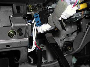

one last pic, it is the hacked up greddy plug-n-play-my-a$$ harness connnected to the ignition.
Attached Thumbnails For those with Blitz DTT turbo timer-greddypnpharness.jpg
