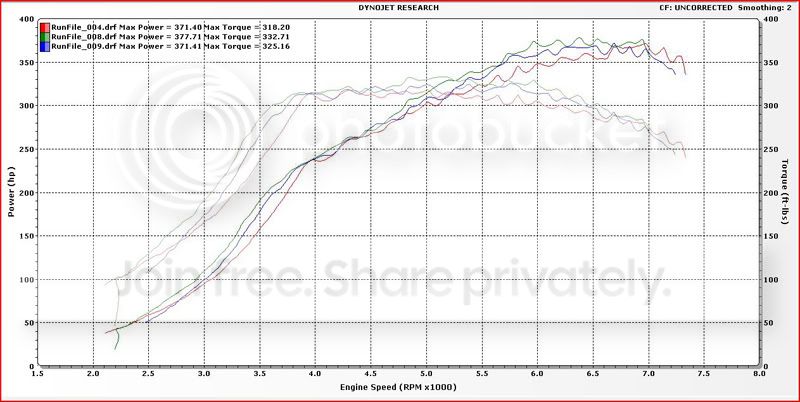

Gains are to be made....
Just for comparison sake....here is a dyno plot of three different cam gear settings, no other tuning was conducted...the red run ( 4 ) was -3/0, the green run ( 8 ) was +2/-2 and the blue run ( 9 ) was +2/0....not only did the +2/-2 bring my boost sooner but it also had gains from 4.5k - 6.5k aswell...
