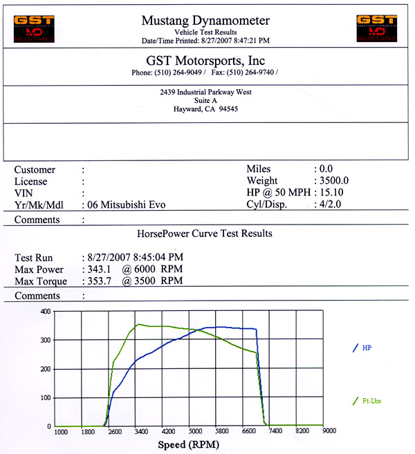

I'm going to have to agree with this.
On our mustang, if you do the proper synch in each gear, and have good boost control the HP will be VERY close. The peak torque number will go up a tad because the boost hits sooner in the RPM range.
If you *do not* synch the car for the 4th gear pull (and it is synched for 3rd still), then I have seen the numbers change.
Here is an example from our mustang dyno:
3rd gear, roller speed synched for 3rd gear at 3,000 rpm:
4th gear, roller speed synched for 4th gear at 3,000 rpm:
Originally Posted by 9sec9
If so, I'd like to see the same car, same dyno, same tune on a 3rd gear vs 4th gear example.
See above.
See above.
Exactly my point. Thanks for sharing.
