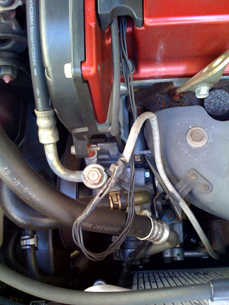

Well that was craptastic. I paid out $45 so they could tell me they wont touch it. Whoever owned the car wired in their own O2 setup and apparently its not to spec. They told me it would be $340 for the O2 sensor and around $150 for labor. ...$500
I called the place that sold me the car (who told me it was covered under warranty) and they said Id have to take it to them and their Mitsu dealer would "maybe" fix it. Of course being in Mass and them being in NY I would have to lose 1-2 days of work and expenses getting there and back so it would probably wind up costing the same as doing it here.
Im attaching pics so people could check it out the current setup and maybe offer up thoughts/ideas on it. Im almost thinking it might be more the wiring setup than the actual O2 sensor? Maybe the it needs more shielding?

Another pic of the O2 sensor

Old Dec 4, 2008 | 06:48 AM
rgeier11's Avatar
Posts: 135
Well, that hack job looks like your problem.
Old Dec 4, 2008 | 10:32 AM
djrndm's Avatar
Joined: Nov 2008
Posts: 112
From: Mammoth Lakes, CA
Indeed.
I was able to get a sticker today. Now I'll take the time to rewire and properly shield things.
