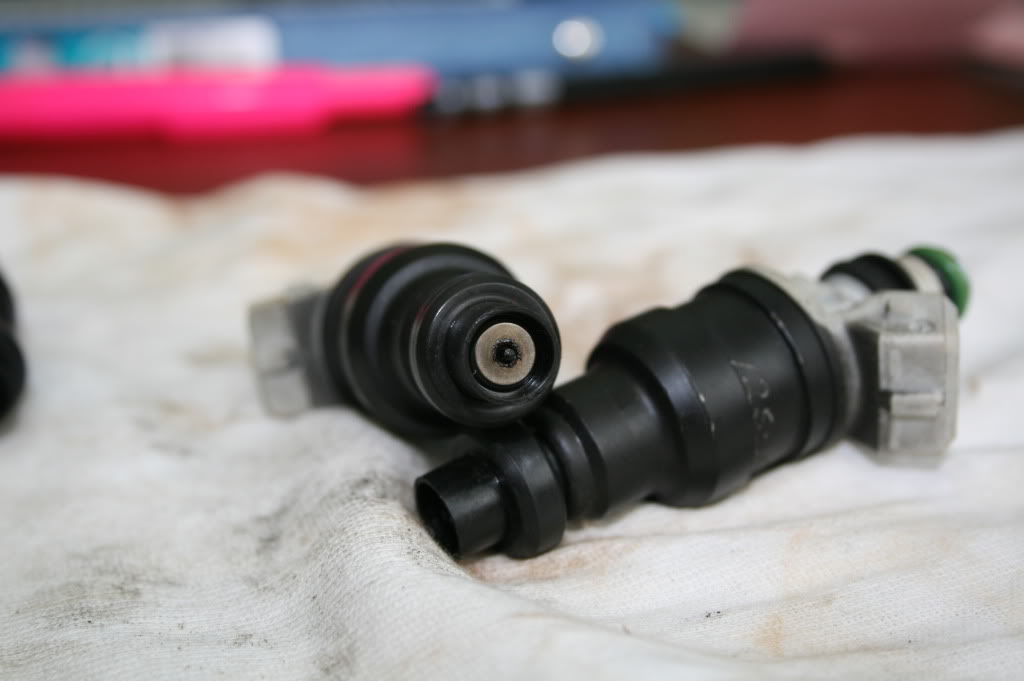

Originally Posted by 1BAMF
No one is saying that its unsafe its just let it be noted to take extra precations when running this fuel.... ie: frequent fuel injector checks would be advised.
very good advice, here is what my injectors looked like after about 10 months on e85
