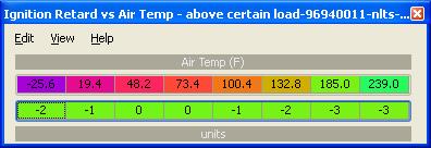

Anyway, here are the tables from the stock ECU that controls when and how much timing gets pulled due to intake air temp (as measured at the MAF) as well as the corresponding min load table:
Good info, I hadn't really gone out of my way to dig for it but I figured it had to be there. Looks pretty similar to how DSMs are scaled.
