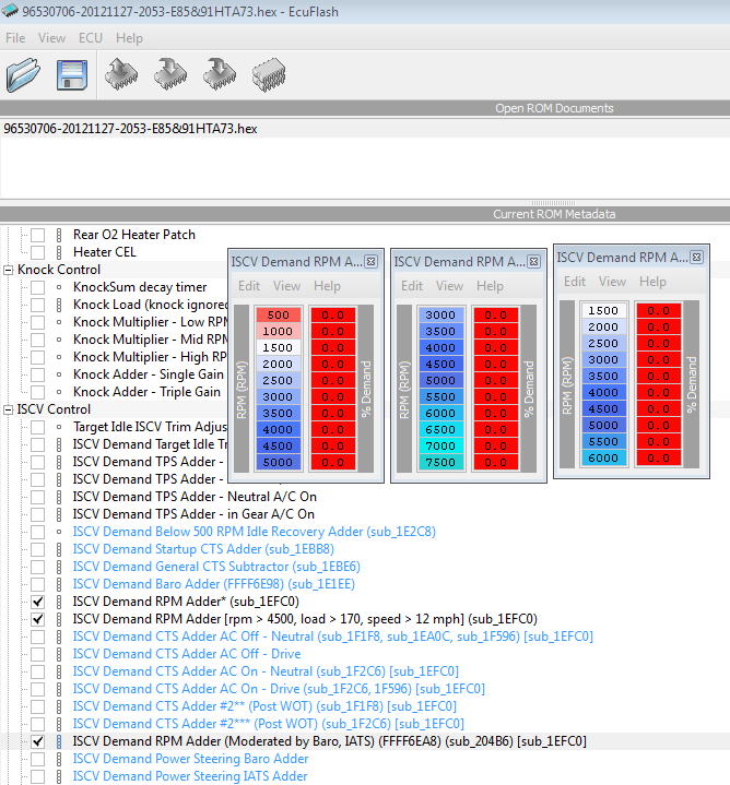

Throttle Hang Fix
If you are on ROM 96530706 you can fix this by zeroing out the three ISCV tables shown in the image below.

There are fixes for throttle hang in the ECU.
But just in case on my car the factory TB plate Screws had came lose allowing the shft to move back and forth and the throttle plate would hang up on the side of the TB. So glad I did not lose a screw into the motor.
